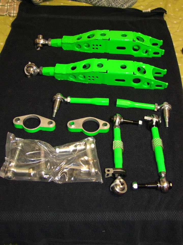

thanks dara for the pic.....so it would go into the rear of my mega arm?

Correct, but why would you want to put these in your mega arms??? Wouldn't you want the spherical that are with the mega? In fact can you even put sleeved bushings as a replacement for those sphericals? Btw, I love the color of your arms too !! I don't mind selling them to you, but I would want to know why first because I don't want to sell them then you won't be able to use them if it doesn't work out for your mega arms. Unless your going to replace your OEM arms.
The spherical on the mega arm replaces the factory INNER bushing, not the OUTER one that we are talking about here. The OUTER bushing is not in the arm, it is pressed into the axle carrier, and fits where the slots are in the mega arm. So the mega arm does not replace the need for the bushing.
nm, disregard,im stupid dara....
just realized you were saying your TRD bushing goes where my spherical bushing is and i def dont wanna change that out
yeah as i said im retarded i was thinking it was the other bushing
im looking for the same bushing you'll are.....that it goes on the OTHER side of my mega arm
