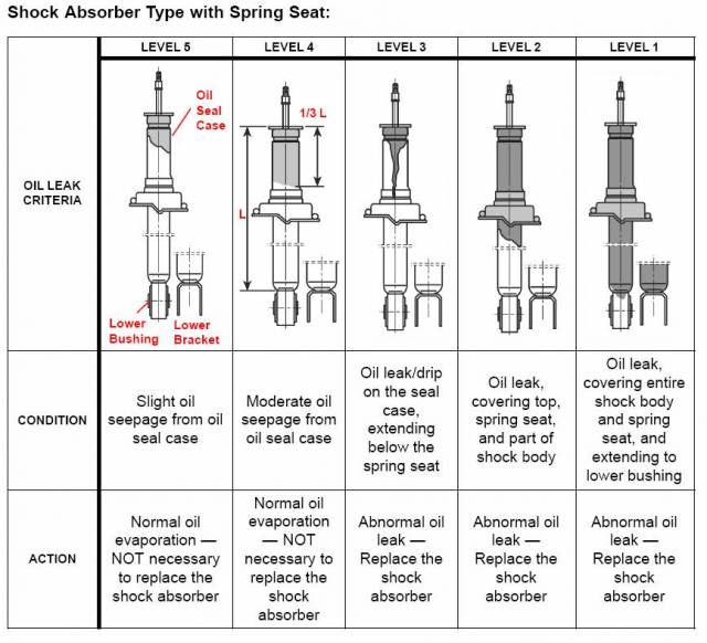

Just cuz it's a pet peeve of mine...they're shocks, the 2IS doesn't use struts.
But, really, that depends how much they're leaking... if you do a search I believe Lance once posted a graphic from TIS showing how much leaking was considered time-to-replace for the 2IS shocks.

MSRP on OEM is $236.21 each. Internet retailers sell for ~$200.00 each. Here's the info on replacing the shocks according to Lexus:

also, lobuxracer..thanks for the info. very helpful. i will try to get under the car when i have time this weekend.
