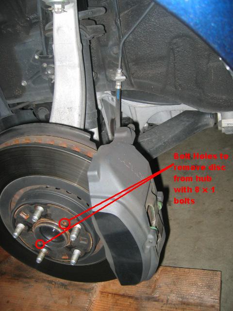

Did you thread bolts into the holes in the hat to try and remove the discs without messing with the hubs?

No... Took off the carrier and pounded them off.

Where do you get the bolts to remove the rotor?
Old Nov 22, 2008 | 05:44 PM
sinister2c's Avatar
sinister2c
Posts: 1,769
Likes: 178
From: fl
if you work on cars enough you should have a bolt to put in there. It looks like a 12mm head metric thread bolt.
Technically the size is 8 x 1. Most often they have a 12mm head on Japanese cars. Euro cars use a 13 for the same bolt. If you go to any auto parts store that carries metric hardware, just find an 8 x 1 x 20mm and you'll be fine.
