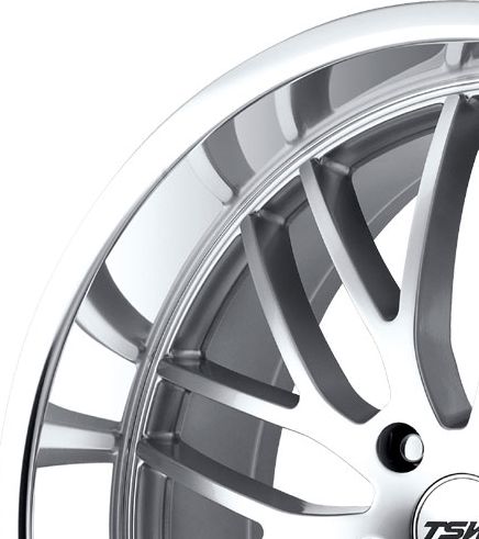

I'm running these:
Go to autozone, they have a ton of different types of wheel brushes that shouldn't make cleaning that mesh too bad.
