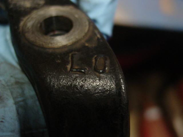

These are out of a 98 model.. I do not know the history out side of the Lexus history and the ball joints where never changed my Lexus but, I cannot say.
When I changed mine a few months ago I could not tell the difference between the new ones and the old ones. There where different numbers on them but I don't remember what the new ones said.
Gsteg is right but, Lexus is wrong for letting him be right. Toyota really needs to step up and make this right.
Here is another pic..
BP

Supraboy..
Did you get either of your old balljoints back?
I would really like to see more closeup clear pictures of what you get back.
You can see mine above.. They have ALOT of grease..
I think this is really proving to be a lubrication issue.
