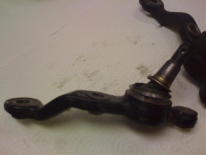

Lower Ball joint failed today - with pics
This is why i always emphasize that all 98-00 GS should get new balljoints, especially if you dont know if they're original or not. Putting the 98-00 balljoints next to the 01-05's, they look a bit different. All the 01+ GS i've done never had any play in the balljoint. It's usually the 98-00 GS that has some sort of play. Thankfully, the ones you buy from Lexus are the same ones as the 01-05 balljoints.
I haven't really seen any 01+ failures. But who knows, there are always exceptions.
Do you know how I can tell if they installed the new 01+ joints, I did not have the service done at a dealer.
Thanks!!

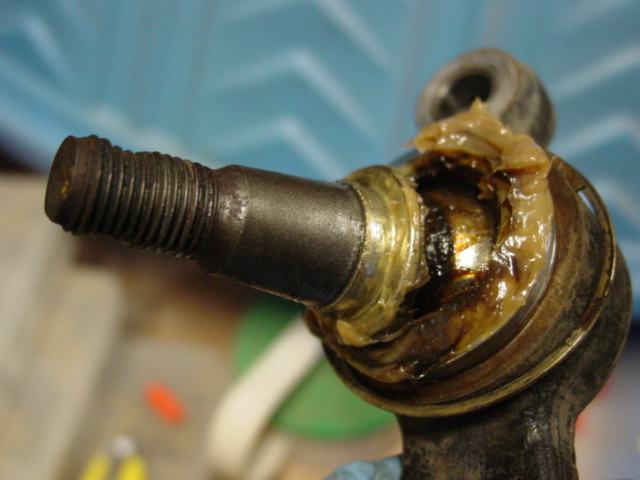

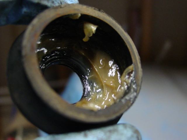

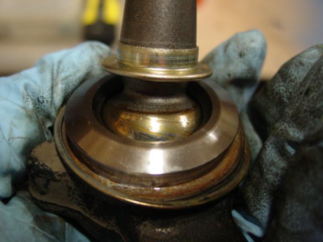

here are the pics of the both joints..
Chirs.... In this picture right here does it look to you like the shaft(?) rubbed and rubbed and rubbed into the side of the socket causing it to wear break rather than snap?
Does having them in your hands help you determine why yours broke?
How did you get the ball out of the socket in one of your other pictures?
I will try to get the boot of my old ball joint tonight and take pics.. I will try..
Thanks for the pics.

I still don't understand why they cannot make these stupid things safer.
It is not in the pics, but the rubber was attached to the drivers side, just like the passenger side.
- When I had the car up on the lift, I checked out these ball joints and to me they looked OK. The rubber was shiny and new looking with no damage present..
Again... Chris.. how did you get the ball out of the socket? I took my boot off of one of my old ones.. It felt tight although I could move it much free-er then the tie rod end not that means anything.
SORRY TO YELL... I COULD NOT GET THE BALL OUT OF THE SOCKET WITH MY HANDS.
Anyway the very first thing I did when I got home was straight out to the garage with the gloves on... took the boot off.. wifey comes out out and says what are you doing. I did not want to tell her... so she waited and talked about her day.. bla bla bla.. then she asked me again.. well here goes.. I am playing with my balljoints... she said... Okay.. I don't wanna know..
Here are some pics..
