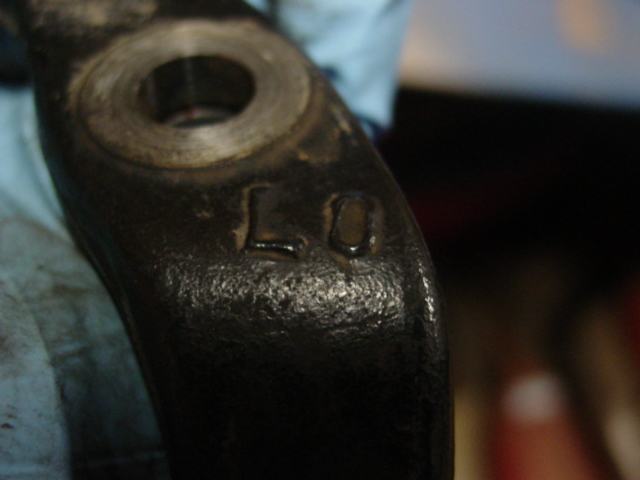

And the last.. if you want another at a different angle let me know.. This one.. I don't know is this a date code? How do they know the part numbers if they fell out of the Toyo bag?

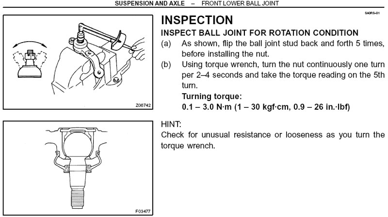

You fail this test.. I think my old one would as well...
BP
