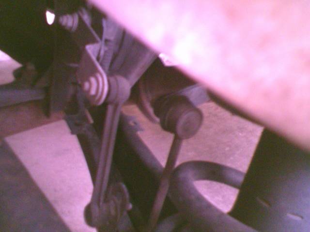

Jonathan.. Thank you! This thread was very helpful during my recent suspension install. I didn't quite use the same method on the front ones as you did, but it was still helpful nonetheless. However, a couple of my friends and i came accross and interesting piece on the front and rear left sides that we couldn't identify:
Does it say anything about this in the shop manual? We all had guesses about what it was but none of us were ultimately sure what it does.
Anyways, thanks again. For some reason my tires are squealing whenever i go over fresh payment and i think it has to do with removing my camber bolts on the front two. I can't wait to get it alligned so i can feel the difference!!!

BlazenHazn, does the car you show in the picture happen to be equipped with HID headlights? Those appear to be the sensors for the self-leveling feature associated with the stock HID headlights. Located only on one side of the car provide data to the computers that control the self-leveling motors that adust the headlights.

WOW! Yes, I do have HIDs and i would never have guessed the stock system were so elaborate. LEXUS!
