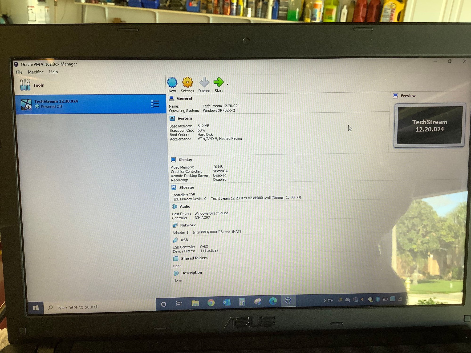

Anyway, the point of my original post was that people should try VirtualBox. You can get any version of Windows on there you'd like, and it's free. Additionally, you have to manually select what's plugged into the USB port (your Techstream cable...). VirtualBox does not assume that you'd like to connect to that device.
See below in this photo: XHorse needs to be manually selected. You'll see a checkmark next to it when you do. I suspect this would solve a lot of techstream+virtual machine complaints on this forum...

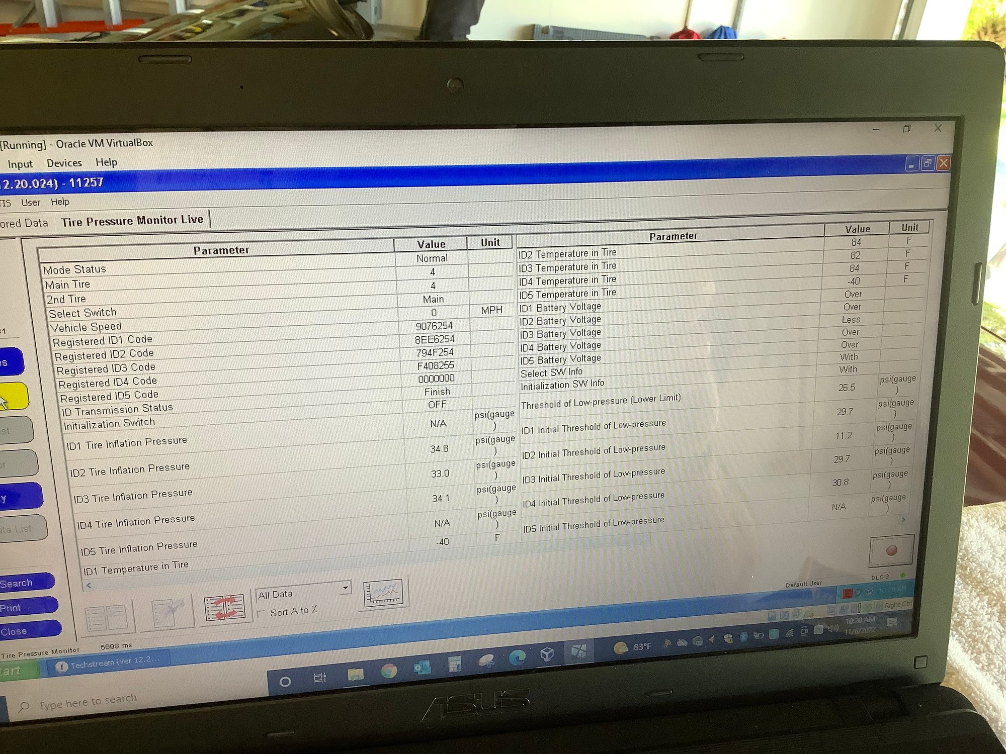

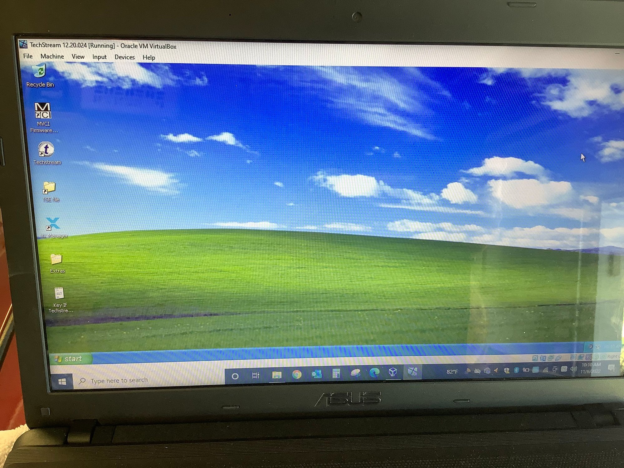

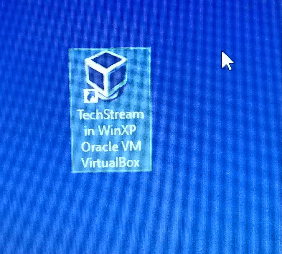

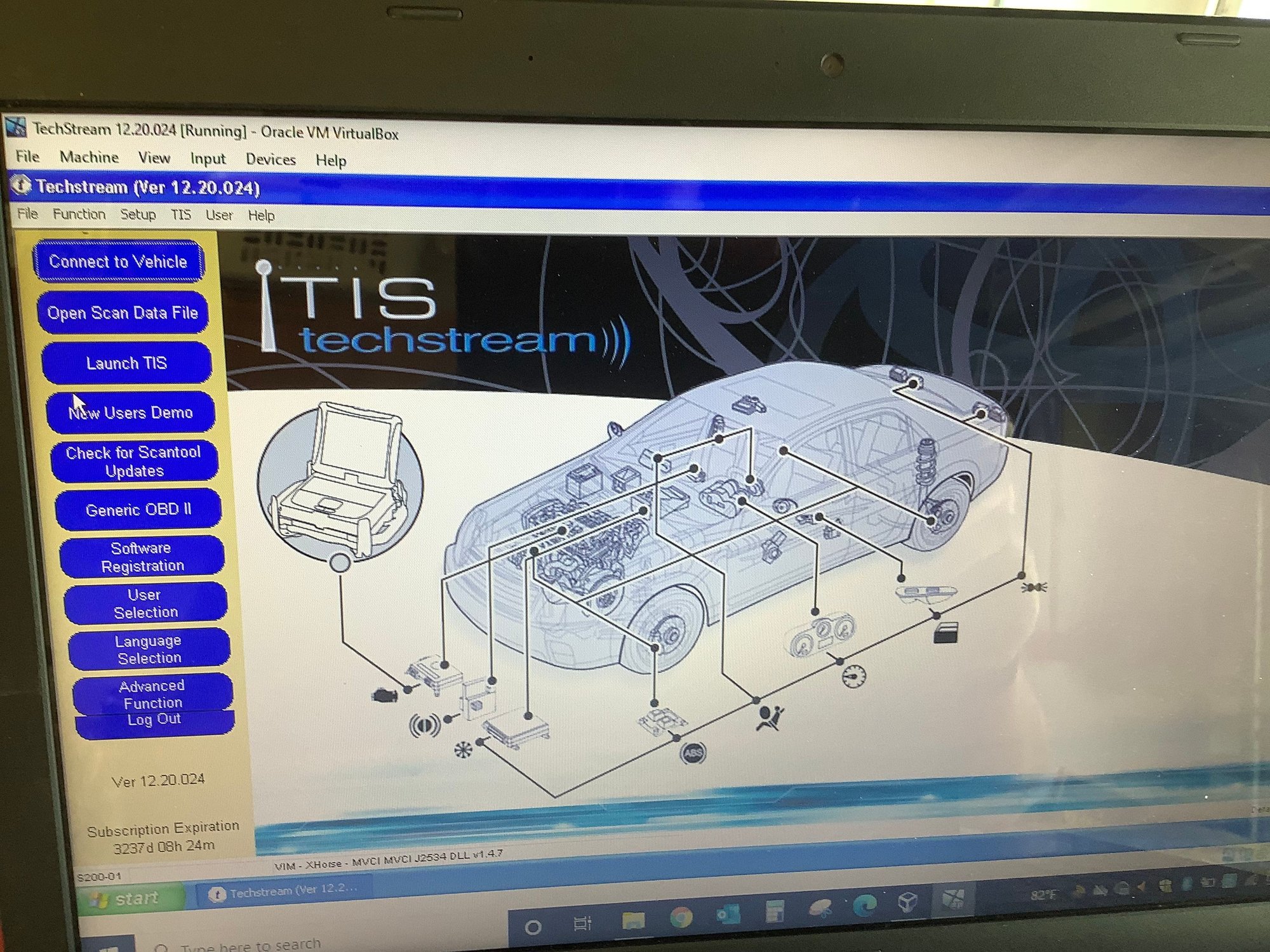

My wife came home last night and reported a flashing TPMS error on the dash so I fired up TechStream on the win10 64bit laptop using the virtual WinXP I loaded a while back.

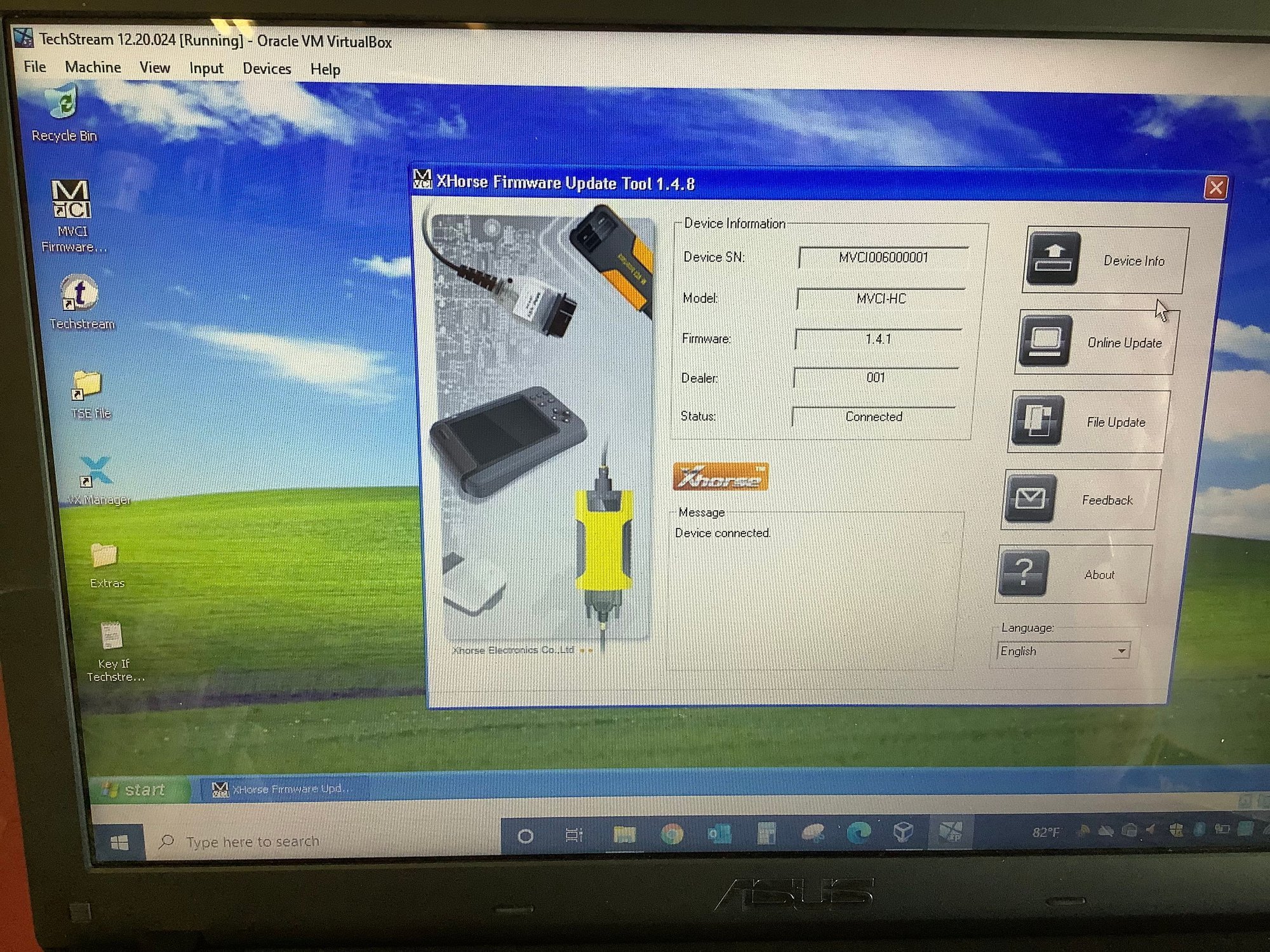

it worked as expected (NOTE: my v1.4.1 cable would only connect using the USB 2.0, it wouldn’t work with the USB 3.0 port) and here are some screen shots.
