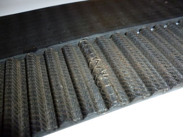

Since our car is now 15 years old and has 63k miles on it and had never had the belt changed, I decided to take the plunge. Glad I did. The tech guy at Lexus said the belts themselves seldom fail; it is usually the water pump that goes first, taking the belt with it, Idler and tensioner were still in good shape so we did the belt, water pump, thermostat and gaskets. Belt had a rib deteriorating so the change was worthwhile. Total cost was $1,300 with a one year warranty. Cheaper than a new engine.

I believe the tech was referring to the pump bearing failure although he did mention leaking seals. His lifelong experience has been with BMW and Toyota vehicles. Since most of the repair cost was labor, I surmised that another $145 for the pump was not a bad investment at that time. 'Free' replacement coolant too.

Water pump at same time as timing belt is SOP for our SC430's. Much of the labor for accessing the pump is already needed to access the timing belt. It makes sense to go ahead and replace the pump, bearings and tensioner during the process. Mine have been done twice and she is due for it again this year.

Always replace idler and tensioner and WP when doing the TB. The Assin kits come with everything you need. Cheap insurance.

Should've replaced the idler and tensioner. Otherwise, 2/4 of the failure points weren't replaced (WP & belt being the other 2/4).
Having said that, the 3UZ-FE has a compression ratio of 10.5, the same as 1UZ-FE VVT-i. We know that the 1UZ with 10.4 compression ratio was non-interference, so I don't think the 3UZ / 1UZ VVT-i are very much interference. If things fail, with luck it may just be fine (which I've read many times online and saw videos of).
