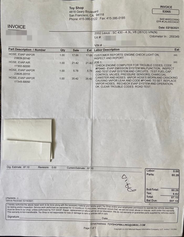

i agree to check the hoses first.
i had that same exact code about a year ago.
for me, the fix was replacement of 4 evap hoses. i’ll let the invoice speak for itself…
owner of shop is HS buddy, hence no charge for labor!
part no. on bag may not match the old hose inside.
Hi, are those 4 hose parts the ones you needed in particular or are these 4 part numbers covering all hoses?
I want to just change all the hoses rather than finding cracked one each time.
hello, i’m pretty sure those are all the hoses because my HS buddy and shop owner has the same philosophy as you. if one is cracked, others are about to.
might as well change them all since you’re in there.
no codes since 🙂
