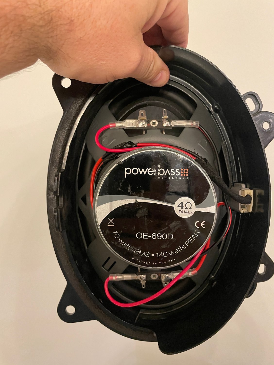

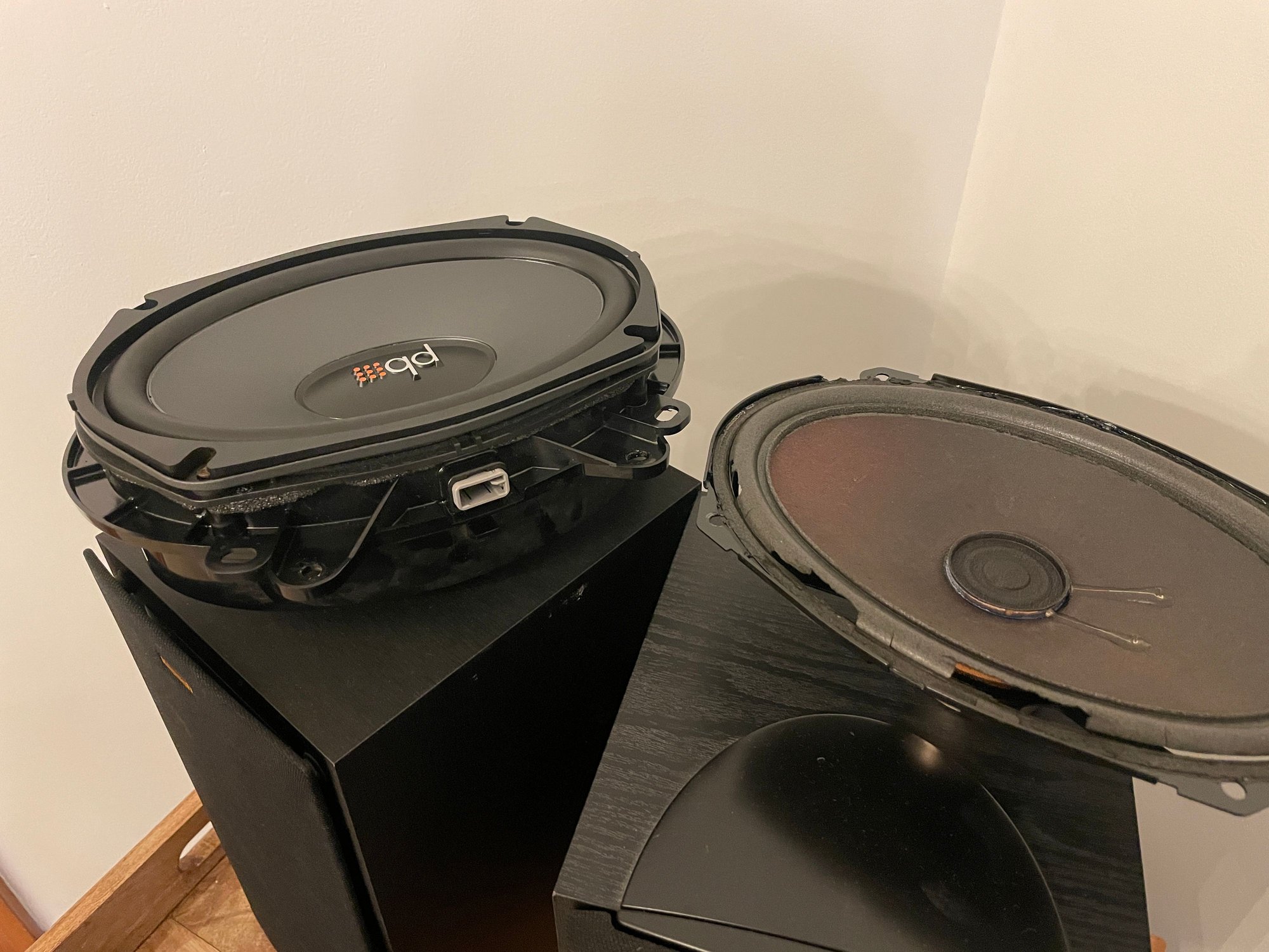

Purchased the powerbass OE series 6X9(OE 690D). It’s a DVC 4 ohm speaker with a 3.25” profile(wired up to achieve 8ohms). At first I was frustrated, it didn’t quite fit in the factory mount. After some cuss words and a few bourbons I figured it out…. Swap over the top spacer ring from the factory speakers and place it in between the new speaker and factory mount. Worth every penny, it sounds amazing.

Definitely appreciate your work…. Unfortunately while I was enjoying the awesome sound, I blew the one of the tweeters on the passenger front😂. I found this out right after I placed my order for new rears and a sub…The joys of owning a 20 year old car.
