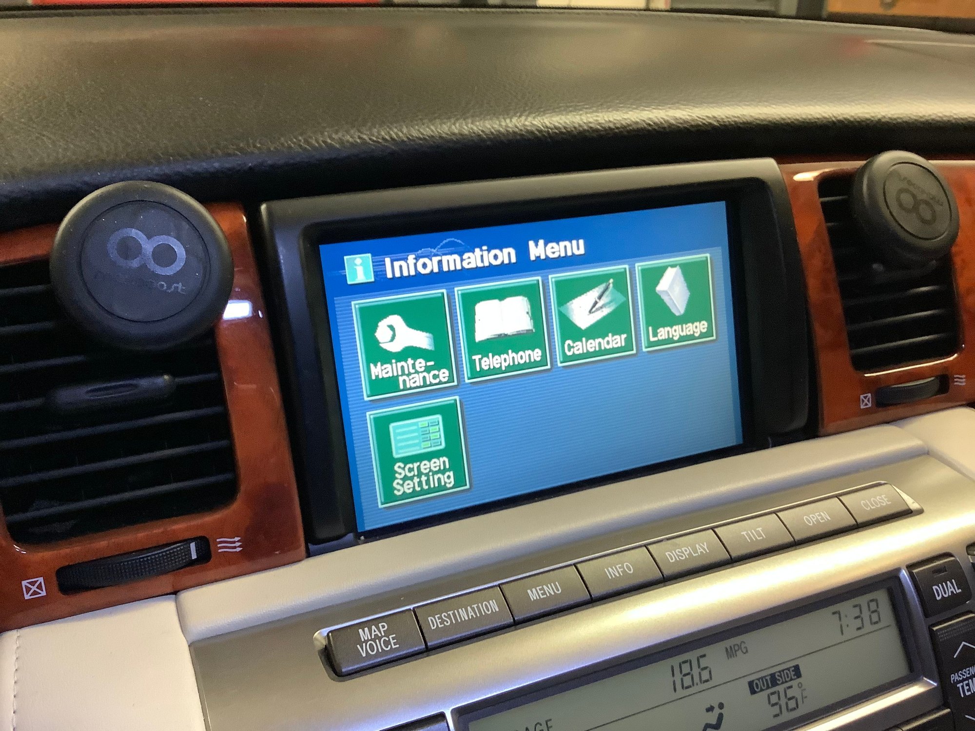

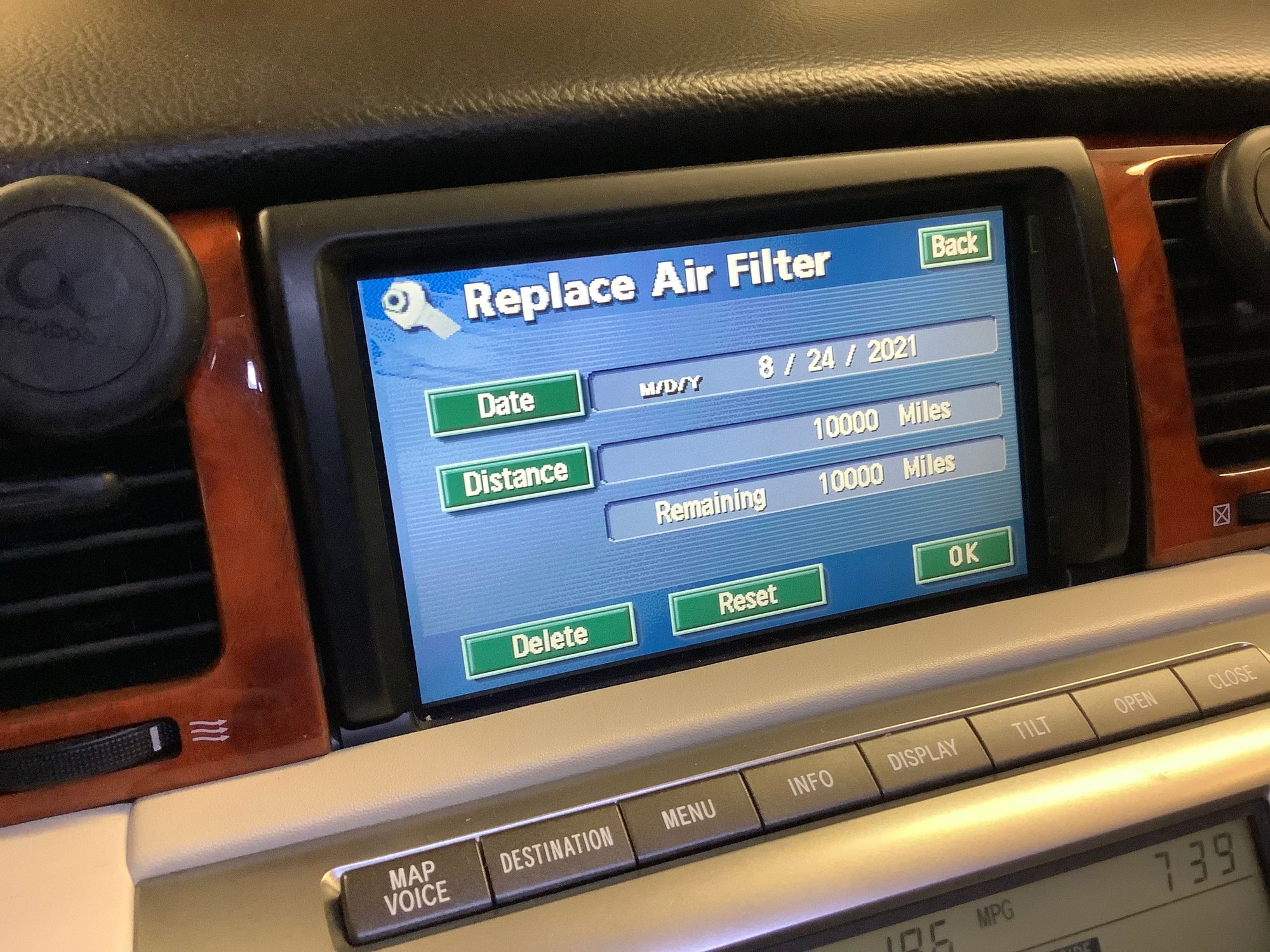

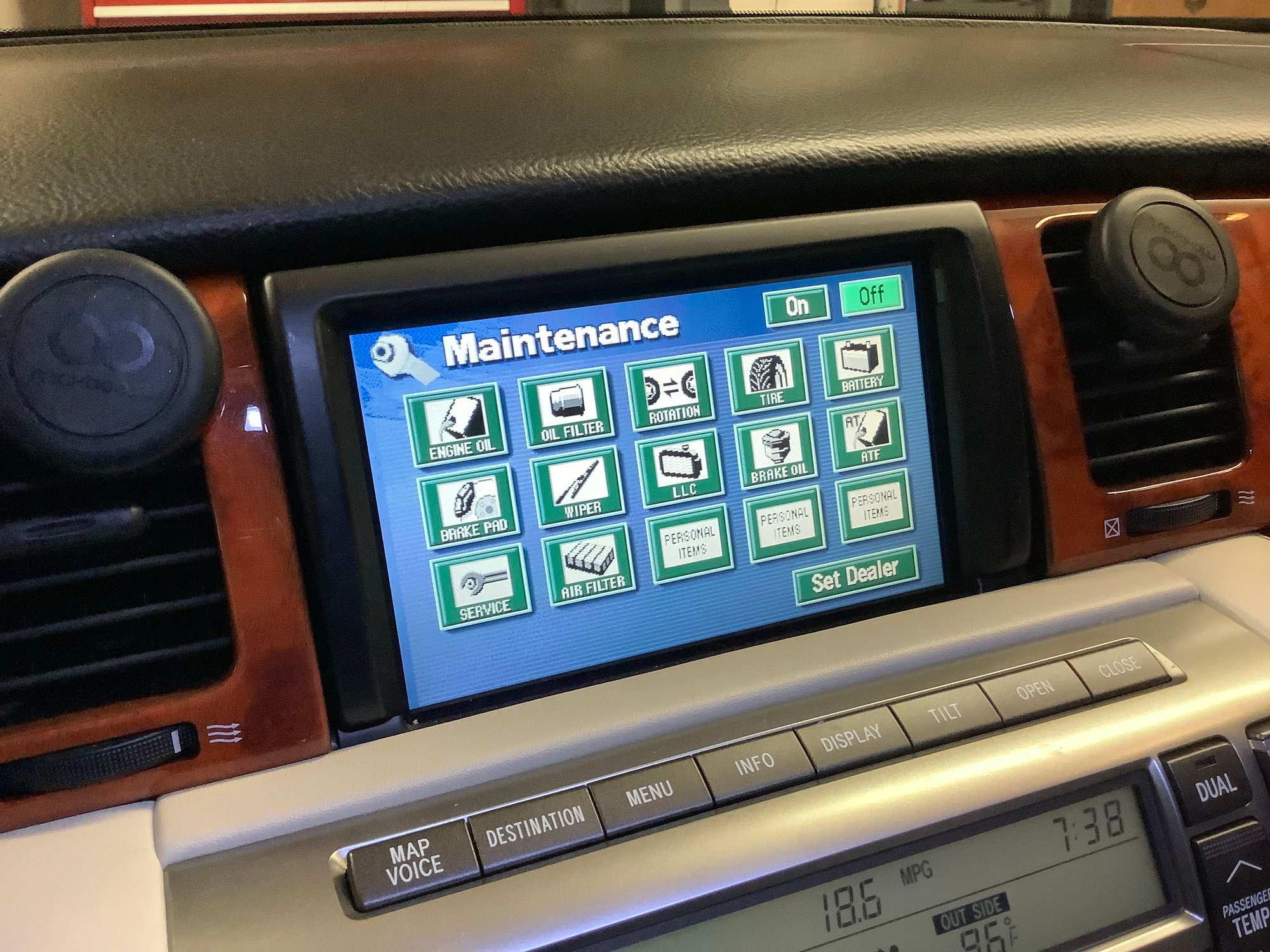

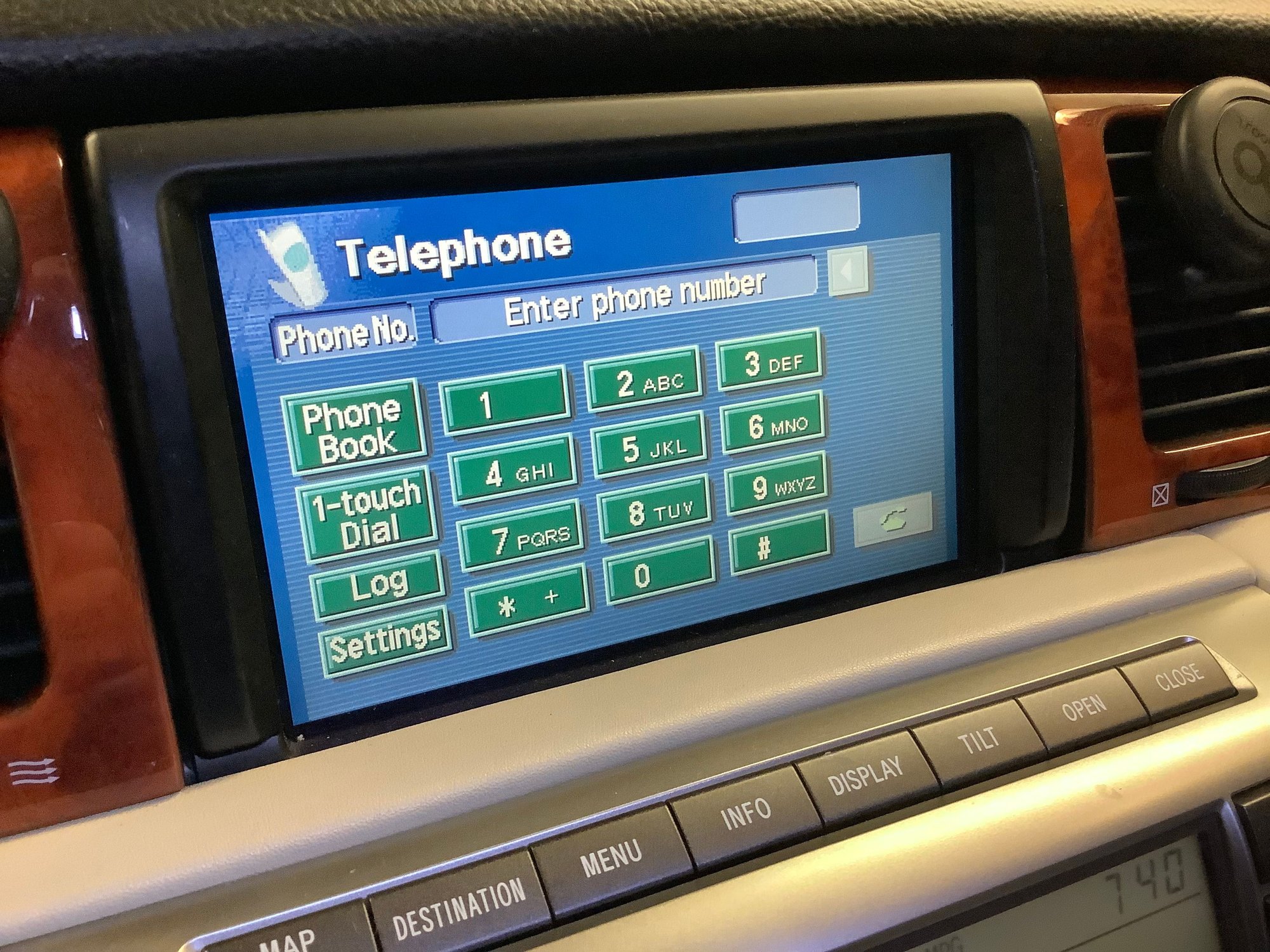

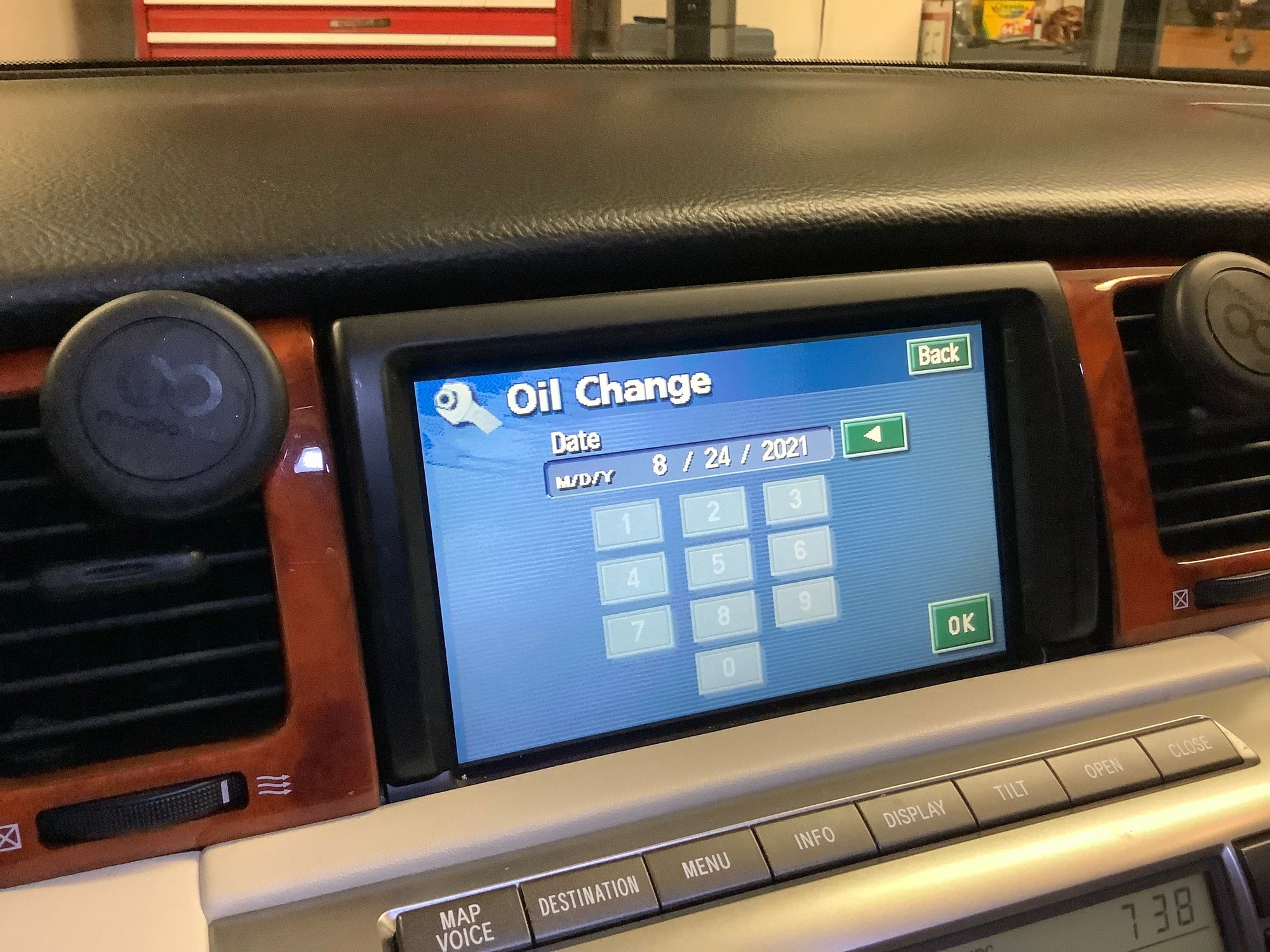

yep, it has the MVA-13L.
it appears most if not all of the functionality still works, including the NAV.
Not sure about te BT phone but it might.
I have BT phone, music etc using the Pioneer radio

I appreciate all of the information and pictures. Clearly the maintenance screens are still functioning and you are able set the dates or distances for the next service. I just want to confirm that once you set a particular function like an oil change that it actually counts down the distance and alerts you when the oil change is needed.

it is plug and play,..the maintenance items will count down and the Nav showed me at my home.
