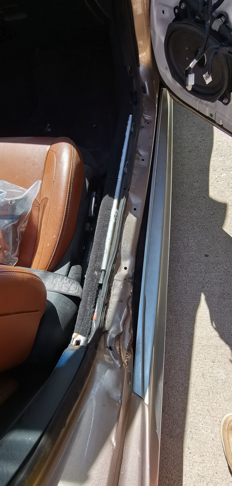

The passenger side rocker was smashed in, you could see daylight through the doorjam and there was lots of noise on the way home!
This is how it looked when I got it. There were no door gaps on the passenger side, the door itself was overlapping the rear quarter panel due to the A pillar being pushed back from the wreck.

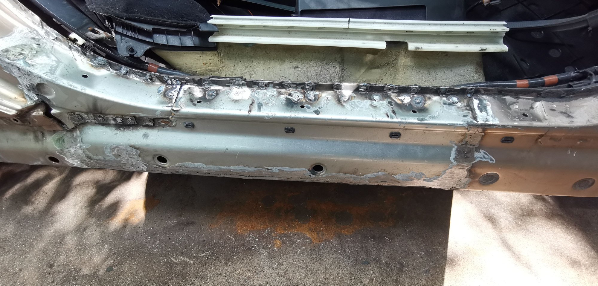

We cut out the thickest layer of the rocker, as well as two thin layers of quarter panel in the corner to prepare the same piece from a donor car.
Primer and bondo go a long way.
