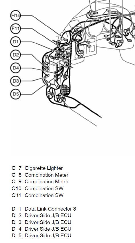

Intermittent problems are really tough to diagnose. In my experience they are frequently caused by bad ground wires, loose connectors, or corrosion.
Given the lights you mention, and looking at the wiring for my 2002 (might not be the same for 2003), I would disconnect the battery. Then disconnect and reconnect all the wiring connections to the Driver's Side Junction Box ECU. In the 2002 it's in the kick panel to the left of the driver's foot. Check to see if any connections look dirty. Maybe give them a spray from something like CRC QD Contact Cleaner. Below is a location pic of the ECU from the 2002 FSM.

I am guessing, just take the kick panel around the driver side fuse box away to access the plugs?

I tried to release the driver side carpet area panel to get to the J/B ECU. It is pretty tough to get to and remove. The emergency brake pedal is in the way. Any suggest how to reach each one of the plugs to clean with contact cleaner. Also the cigarette lighter center at ashtray is not working. Fuses are ok but no fire. This must be a grounding issue also. Any suggest where to check?
