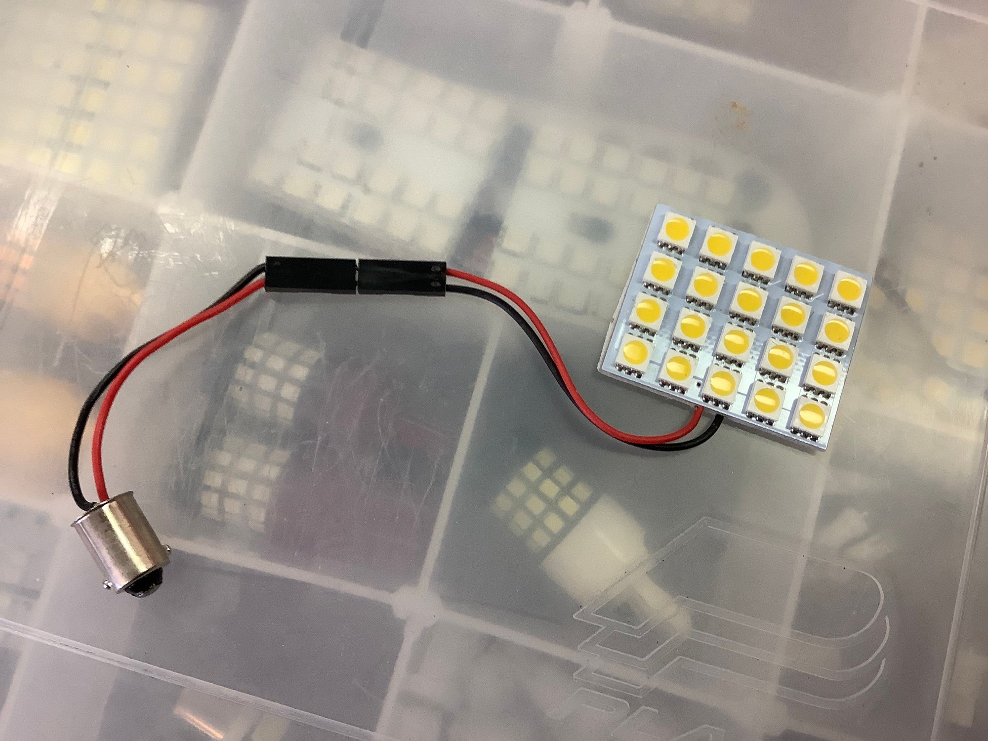

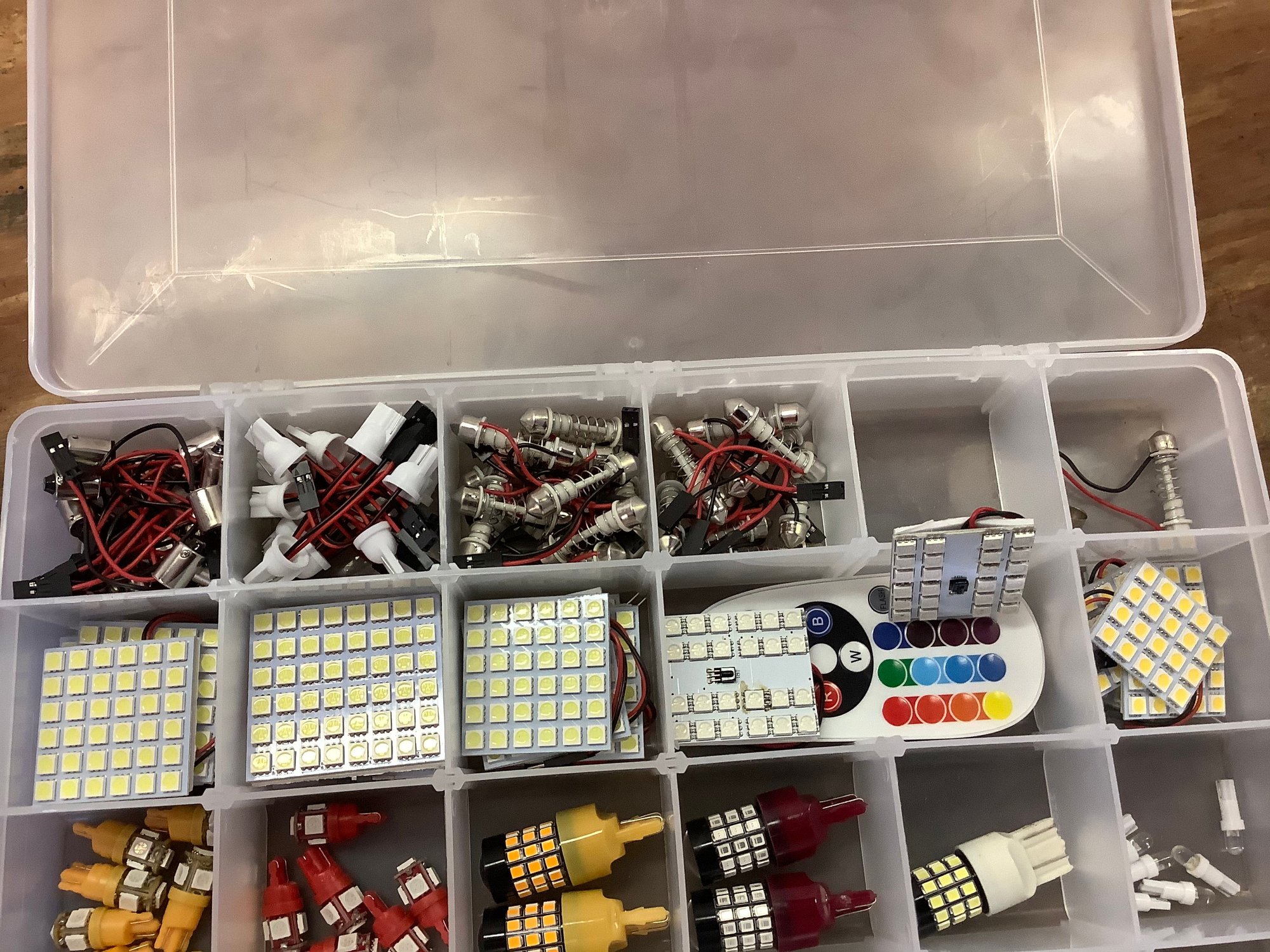

here is a pic of my assortment...note the one with the remote. You can change color or brightness
I used the incandescent looking cool white 5x4 on the far right.
the lights usually come with the three different plug styles. Our car requires the bayonet style on the far upper left.
also, the plug must be reversed black to red

Black to red.
