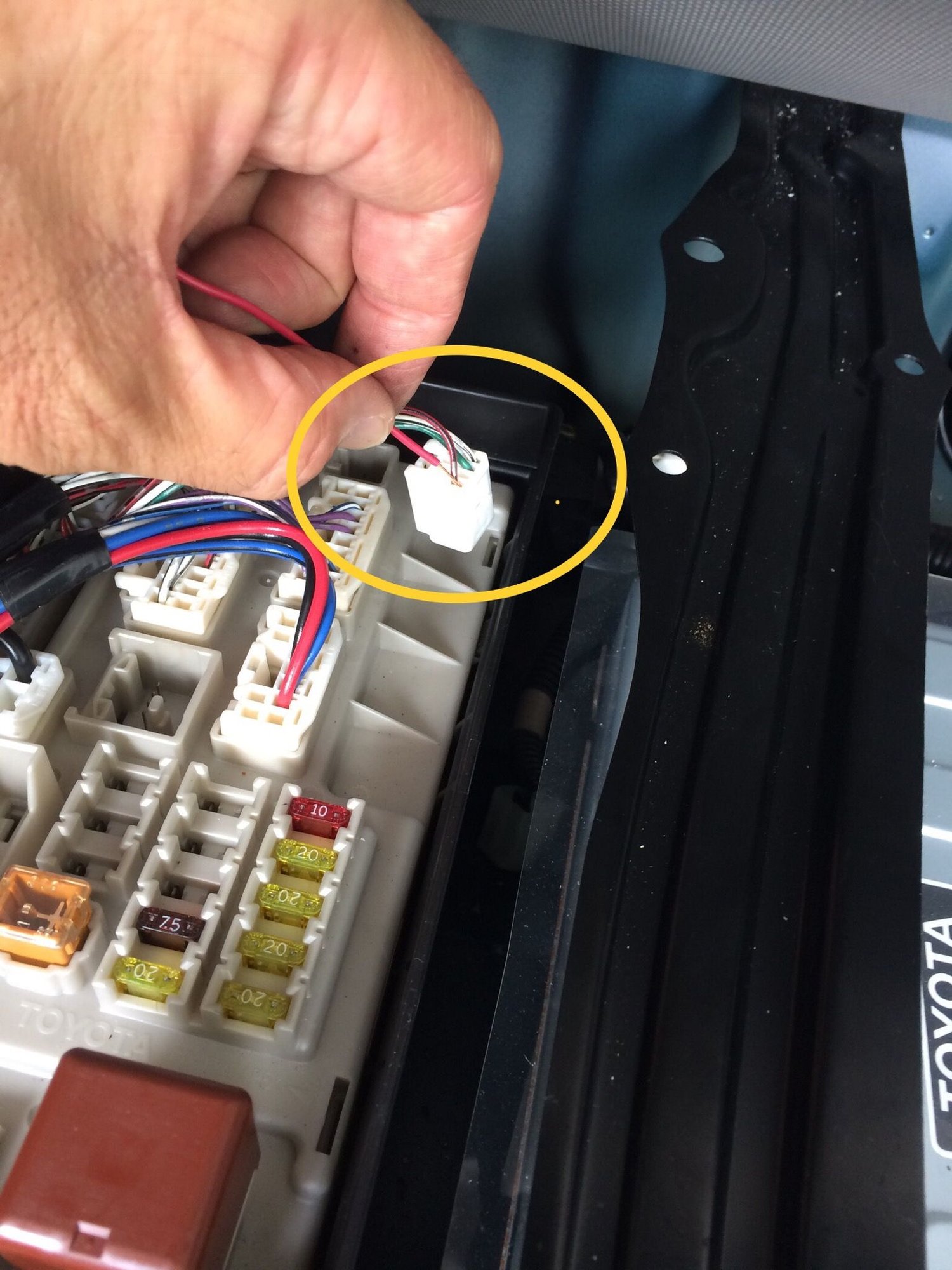

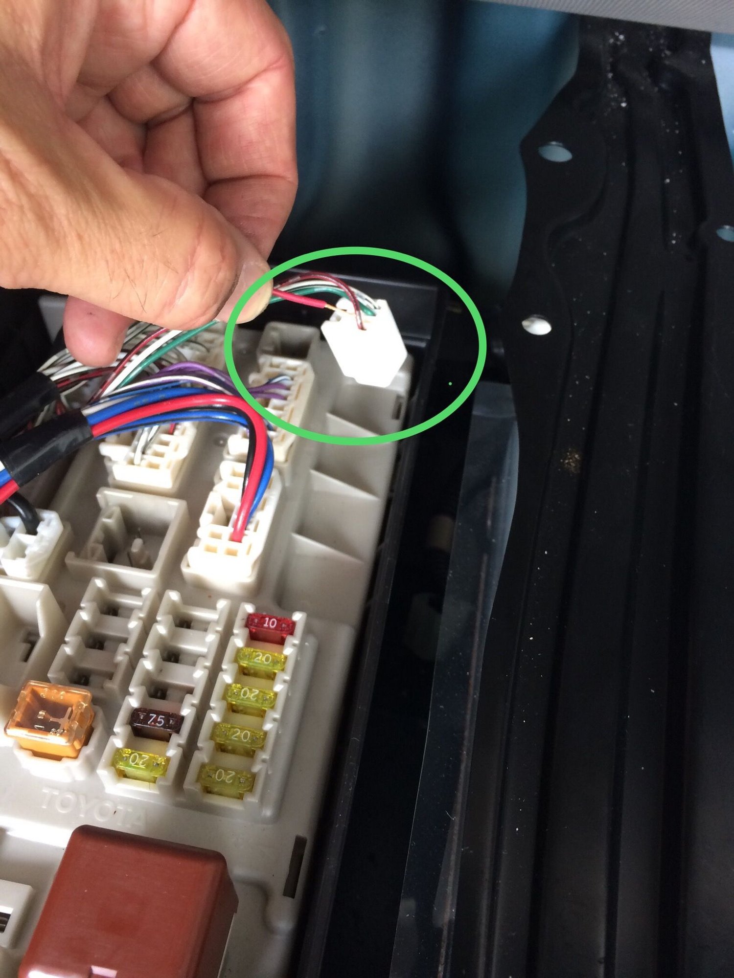

i know you are asking GmanSC but I pulled my the 12v back up lights power in the trunk, left side.
red/silver wire.

You can tap the the back up +12v by BGW method, or you can tap it from the back up light bulb. Just remove the bulb, insert the stripped wire to the socket and replace the bulb. Five minutes.
