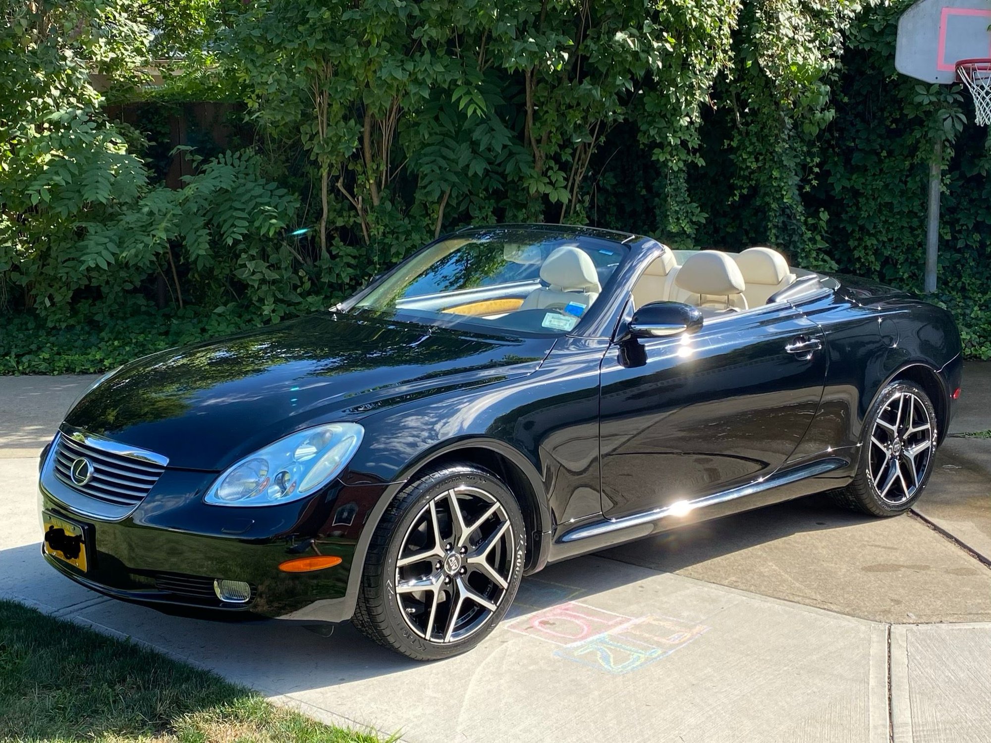

I just sold my Audi TT for a 2005 SC430 with 65k miles on it. It’s never seen rain or snow and I’m trying to get some of the kinks worked out, so I’m reading on here like crazy.
First, I had to get new tires and rims, I’m sorry but I couldn’t stomach the OEM rims that came on it and I couldn’t afford the OEM rims through Lexus that I liked ($320 each) so I went with aftermarket and Goodyear tires. Wow, it made a difference in the ride, but I’m still noticing a wobble or vibration in the steering. I’m thinking new struts next? The rear shocks are definitely leaking. I’ve already received a price of $1700 for all 4 new struts and an alignment (Lexus parts). Does that price sound right to you? I’ve also seen something about a sway bar or something else that might be causing this problem.
I know it won’t handle like the 3.2 Audi TT, but it should ride very smooth, right? The vibration is truly annoying for it being a Lexus.

If that is a picture of the car, it is not a 2006.
Sorry, I fat fingered it. 2005.

Welcome to the forums! I'm new to the forums myself. Regarding the wobble/vibration issue. I am having the same issue (2006 SC at 53,000 miles) and my local mechanic has suggested it's the control arm bushings (just told me this an hour or so before I posted this). I found this thread: https://www.clublexus.com/forums/sc4...-bushings.html. Of course, your issue may be for some other reason, but given I'm experiencing something similar and given my mechanic JUST NOW diagnosed the cause, I though it best to share.
I have a question for you: What exactly are those sfter market wheels? They're great looking.

So, I’ve now read that these might be my two leading diagnoses: 1)control arm bushings or 2)struts. I’m taking mine for a second opinion on Weds to a very well respected mechanic in town. I’m going to run these two ideas past him and I’ll let you know. Are you planning on having that repaired? What did he say for the bushings? For struts (all of them) I got a cost of $1600 with an alignment pre tax.
As for the rims, I got them from tirerack. New tires and rims. They’re called MSW Type 40- company owned by OZ, so I’m Extremely pleased with the quality. They are 18x8 with a 45mm offset. Price was right with new 18” Goodyear’s, came to $1,300 (after $200 mail in rebate). I had my local shop mount and balance them because of the damn TPMS sensors, they were able to reuse my sensors from my stock wheels. Aftermarket sensors don’t seem to work well with a Lexus as the company wants you to pay $$ to them to activate them. I’m glad I researched this issue on here first.

Great, thanks for the wheel info! I've had the stock wheels on since I got the car (about 3 years ago), but I'm through being embarrased. So I'll take a look at the MSW's and get that issue taken care of once and for all. Thanks again.
