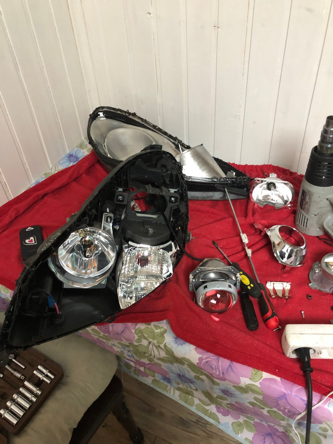

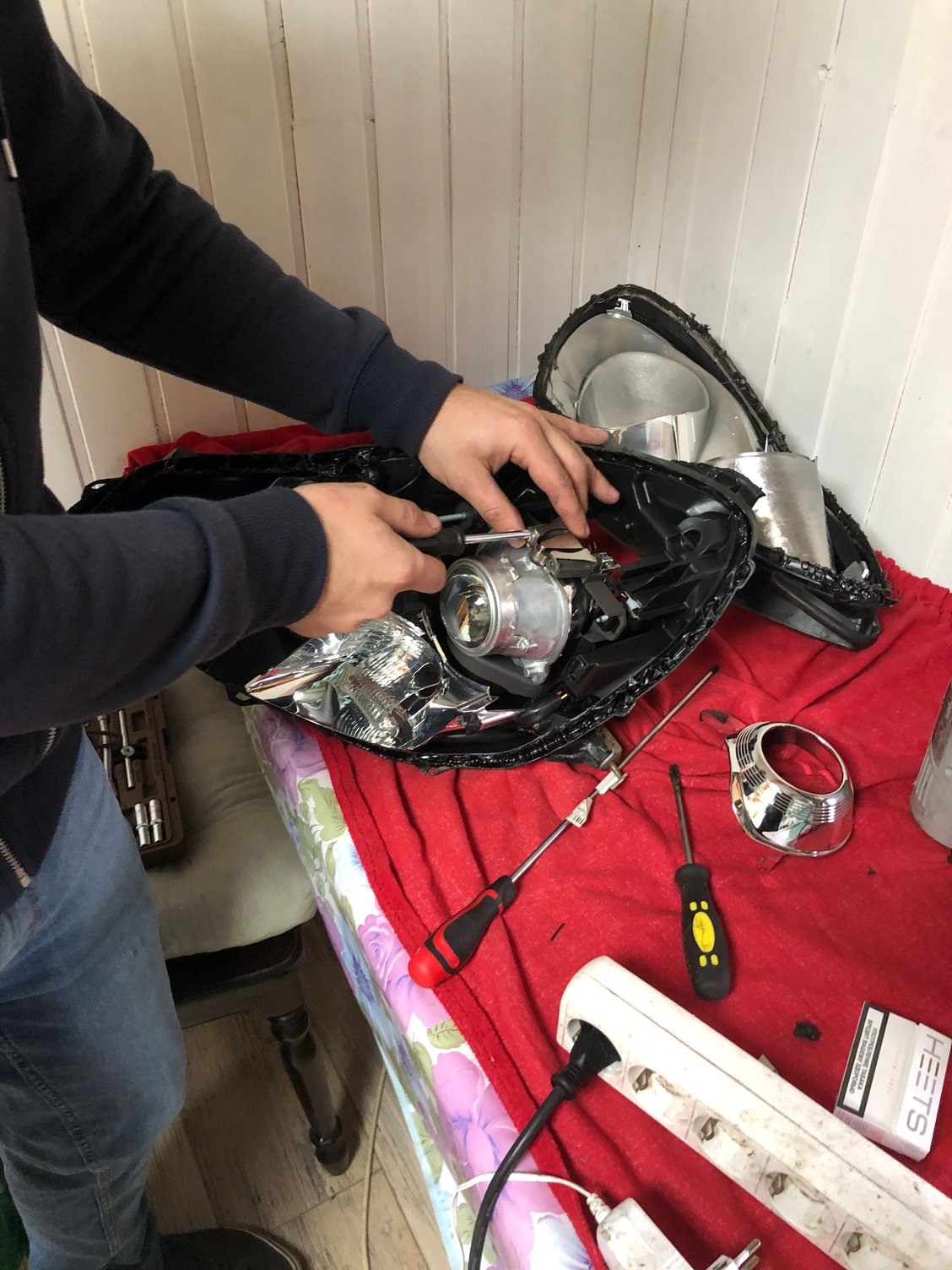

My car is 2004 year and it have the worth light with oem headlights. Recently I have bought 06+ headlights and it have same problem. So I decided to change lens modules on optima professional bi led modules.
Oem reflector was burned and that's the cause of bad light.
Changing lens modules.

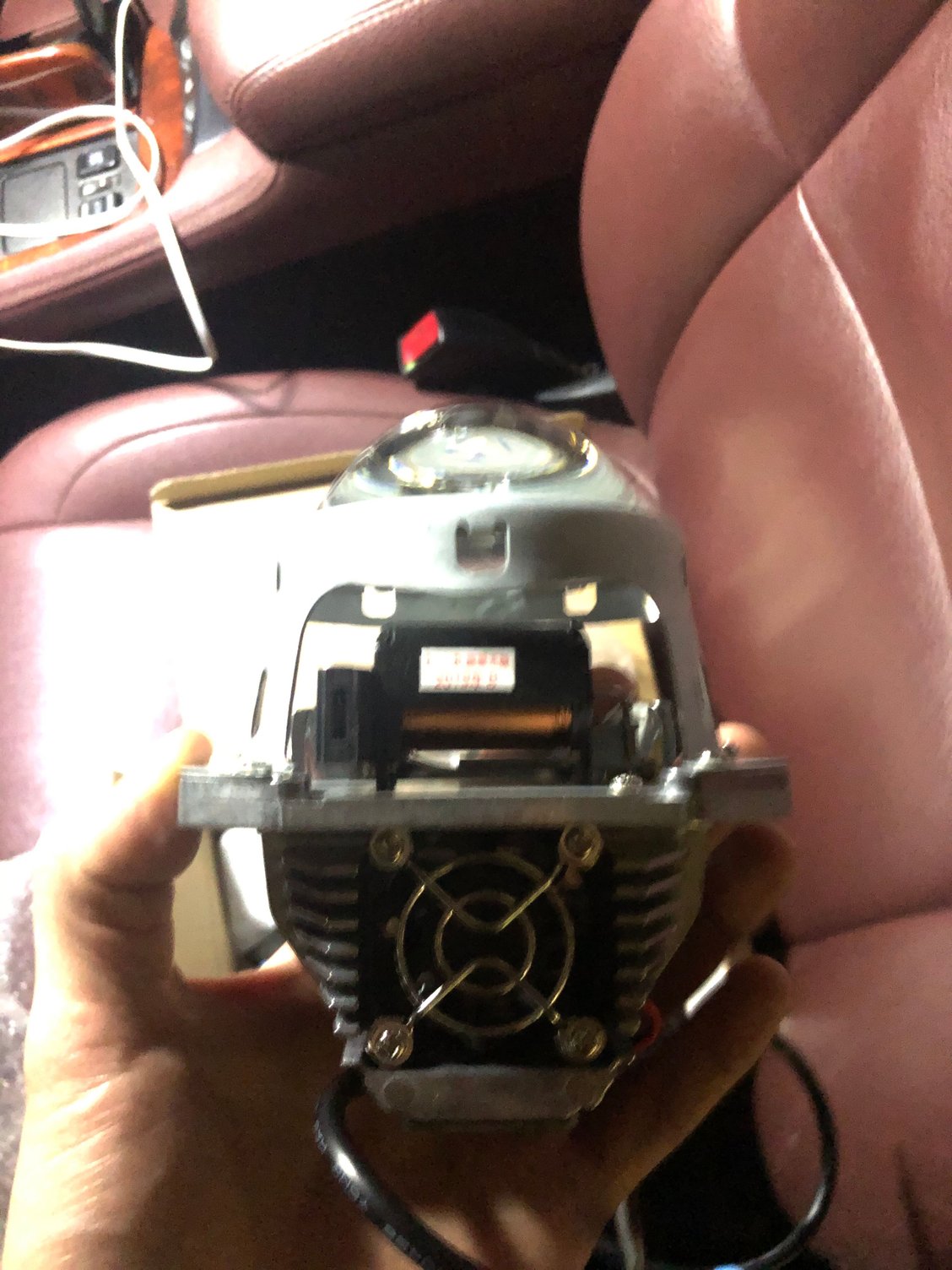

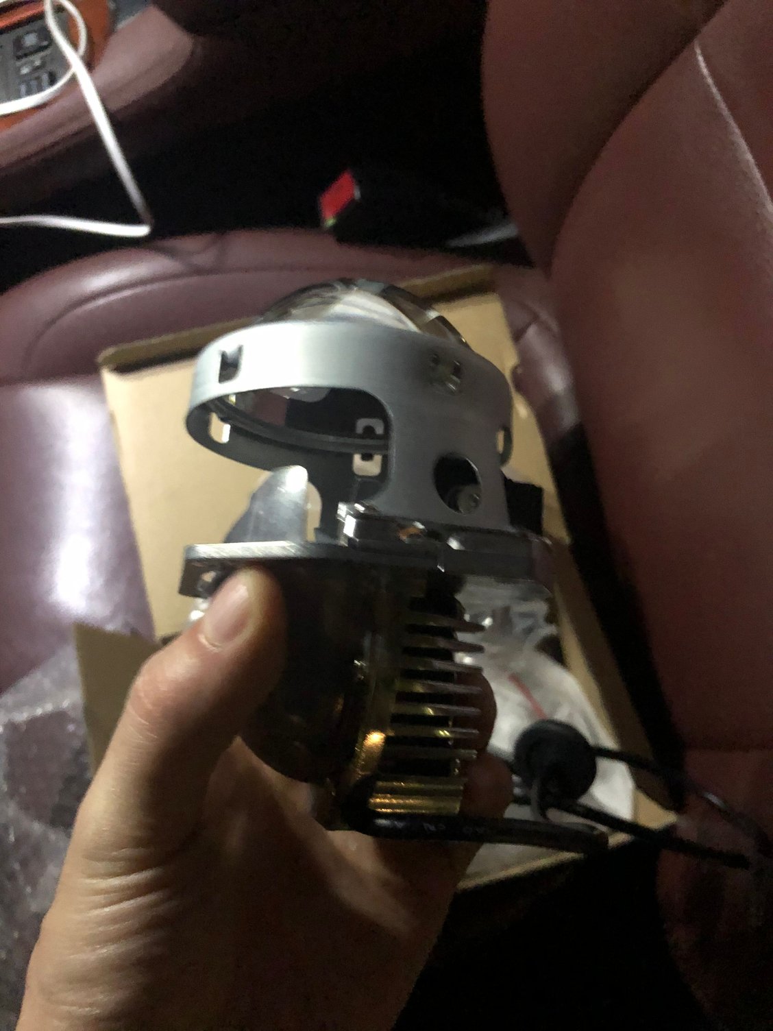

New bi led modules
Now I have two high beam lights, stock and led. Also changed all bulbs on led.

Ok, now back to the lighting. You have 2 sets of highbeams now? Did you have to modify the housing or did they just bolt right in? What kind of wiring did you have to do?

Yes i have 2 highbeams now. I modifed the housing because our car is rare and adapters for our headlight doesn't exist. All wires are connected into the headlight housing.
I used bi led modules, other guys from sc club in Russia use bi xenon modules, there is no much difference, both type of modules lightning very good.
