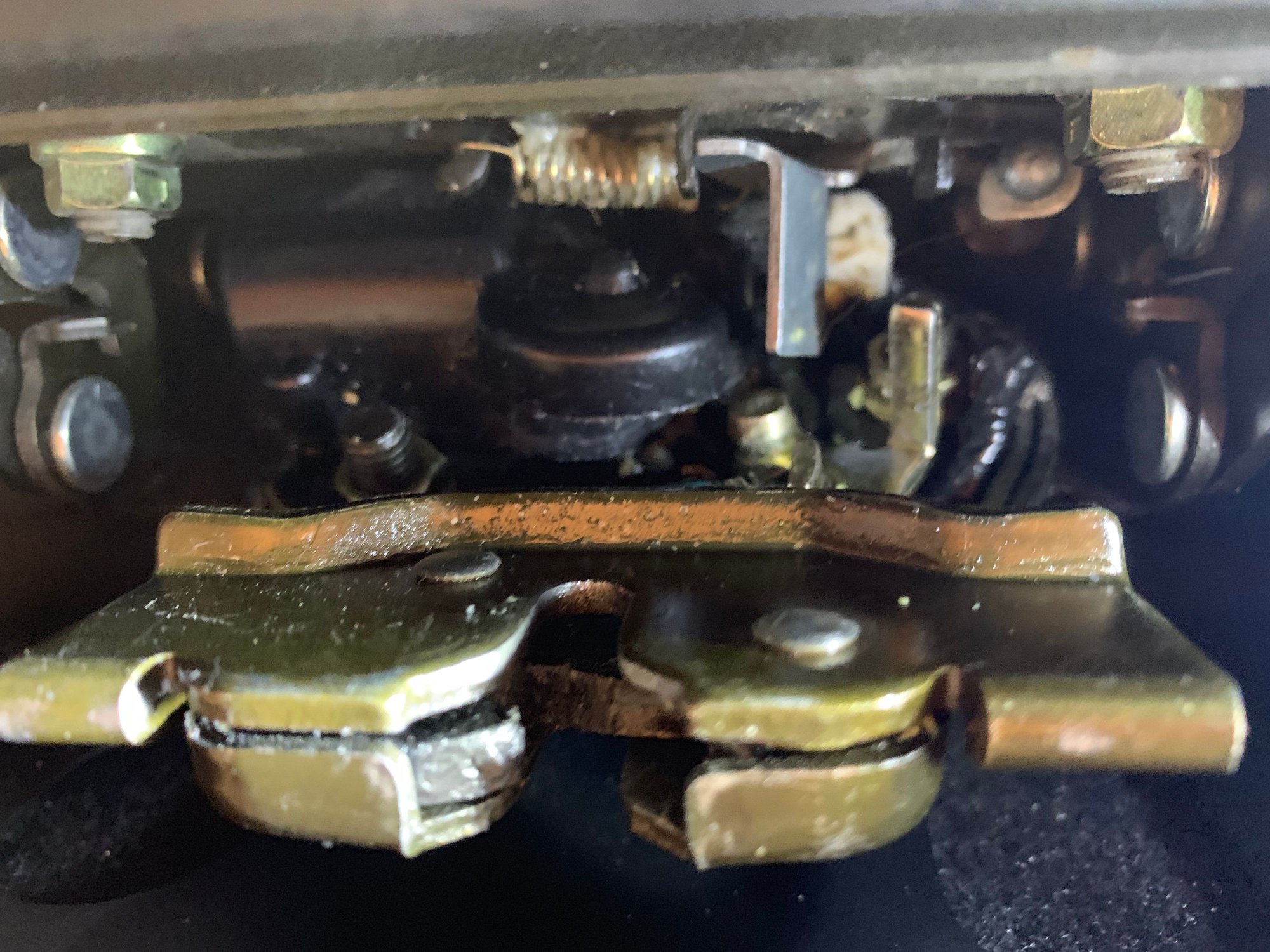

tried sending video but maybe too large so I will attach photo of assembly in open position after I opened from center con
Assembly in open position

Yes I hear a switch like sound. I opened the trunk and when I push the remote trunk opener the rod to open the trunk latch (silver rod in photo)does not open

All those metal shavings in your picture mean something. Chances are it does not mean something good.
Take off the plastic lip cover on the flat edge of your trunk. It has ridges on it and the Lexus logo. It just pulls off. See if the makes the trunk work any better.

I think the rod that causes your latch to go "up" into place is not right. It is the white rod that is pointing to the 12 O' Clock position in this picture.
The reason I think this is because if it was just a "height" issue, taking off the plastic cover would have resolved it. Also, the gaps on your car would be off.
What I think is the nuts that hold the rod in, need to be adjusted.
Pretty easy. Take off the top plastic cap. Unscrew a couple of 10 mm bolts that have "D" rings on them and pull off the plastic retainer clips. That will reveal the two wire cables the remote and emergency release uses, along with the white rod assembly.
Look for anything loose or out of place.
