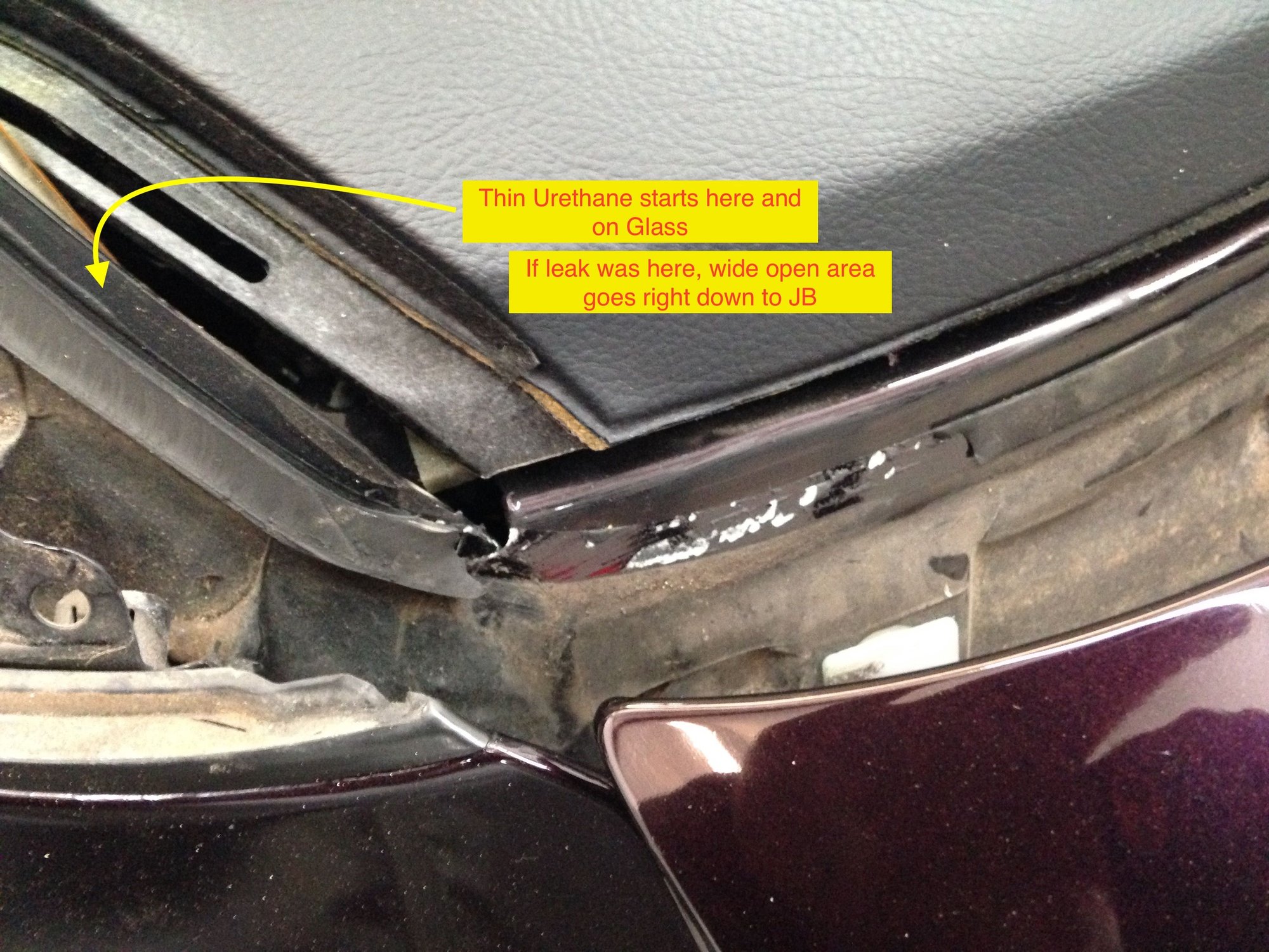

I am updating this post since much has developed on my Wash Car, then Wireless Function stops working! As some of you know have spent months trying to troubleshoot what is up, or should I say down )-:
Two Saturdays ago..I wash my Car, thinking all is well since replacing both the driver Door Belt moulding and inside Weather strip!! And after 3o minutes Wireless stops working again!!!!!!!!!
To start over, It is water for sure, 100%, for some reason my water tests apparently worked temporarily!
Now what to do? I call around and searched for someone who has experience with the SC430 to remove and replace with same Windshield! Many glass shops shy -away from doing the SC since there is many---------parts that need to removed and re-installed to do job.
Found a Glass Company in NC who had 2 people who had a total of 50 years of Windshield experience, and yes, both have done a SC430.
This last Tuesday, I was in their shop to watch them take apart my car! Those 2 tech's spent 3 hours on the entire job! Now I know why most glass shops never called me back to give me a quote! I was doing this on my own $$$
This is what is up:
1-As they where cutting out the Windshield with the wire, there was 2 locations that the Wire skipped and moved quickly through 2 points on the Windshield--
2-Driver side, and passenger side apparently had minimal Urethane, The Tech's strongly believe that water for sure is getting in my car, probably both sides! See photos of Glass Windshield removed and the body of the Car where the window attaches.
3-If you look at the bottom corners of the Frame of windshield, there is a direct correlation to water getting down to the Junction Boxes if Windshield is leaking, tech's commented out is a good thing you decide to bring the car in to have fixed!
Other comments..It is possible that the seal went bad and or not enough Urethane was laid down on the bottom corners when manufactured. This is the original Windshield

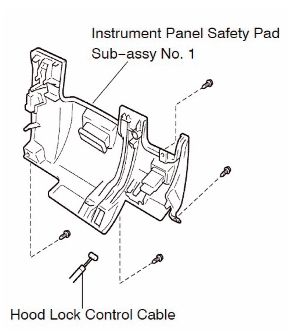

3) or attempt to inspect myself????????? I NEED TO KNOW WHAT STEPS I NEED TO DO TO GAIN ACCESS TO BOTH JUNCTION BOXES---- BobVVTI, do you have the take-parts instructions you can share? I could not find anything on the web or CL.

Everyone has opinions. To get full access to the driver’s and passenger side J/Bs can involve taking down other pieces. For example on the driver’s side I had to take out the panel under the streering wheel. NOT the SW cover, the panel, then pull back the carpeting as shown in the diagrams above. But I was doing an install of the Luxlink with Steve from Luxury Motorworks. Also pulling out the A pillar and, possibly the sill cover trim, helps for access. Haven’t done the passenger side, but it will be close to the same but with the glove box.

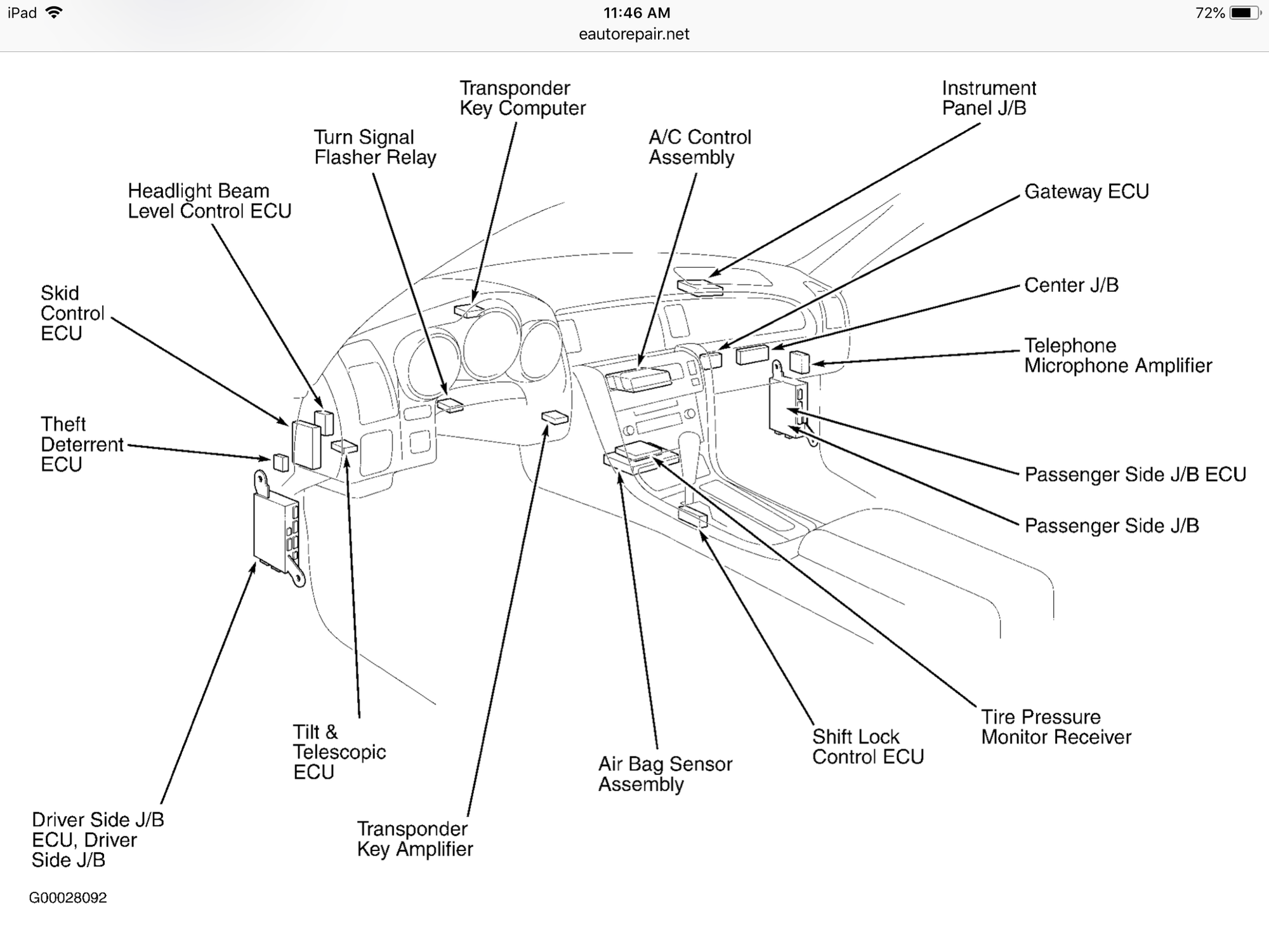

Wait a second.... in another thread you were tinkering with the overhead light and mirror assembly recently. The receiving antenna for the car’s anti-theft system is in the rear view mirror housing. Any possibility there is a connection?
Old Apr 21, 2018 | 04:34 AM
  #104
hoffy5's Avatar
hoffy5
Joined: Sep 2017
Posts: 264
Likes: 19
Hi VVTiBob,
Yes Sir, the shop who performed the 650.00 positive battery terminal replacement was also playing around with my rear view mirror inner parts! So the day I picked up my car, I was told by the owner/Tech the voltage drop across the terminal was the problem. To be safe, not knowing exactly what they played with in the mirror, I decide what the heck, I ordered a replacement used one on the Bay and when they replaced my Windshield, I asked them to use the new used Mirror instead, we then tested at the glass shop, no go!
Key-fob sends transmission to the inside rear view Mirror, then next stop on the CanBus is the Security Module? I also assume then to the Driver side Door MPX Module ? I have also purchased a MPX Module for that door and also a Security Module also on the Bay, those parts have not been replaced!
After reading one of the Post's recently here in CL, Someone had an issue with their blower motor due to corrosion in one of the Junction Box ECU's. So that is why maybe my issue is with a JB due to my Windshield Leak?

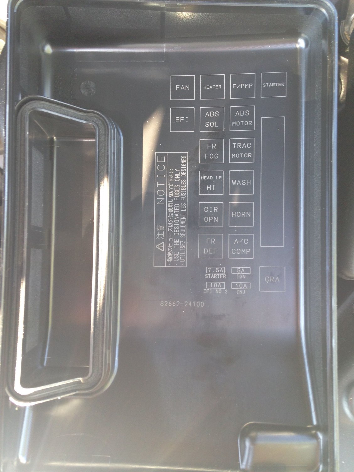

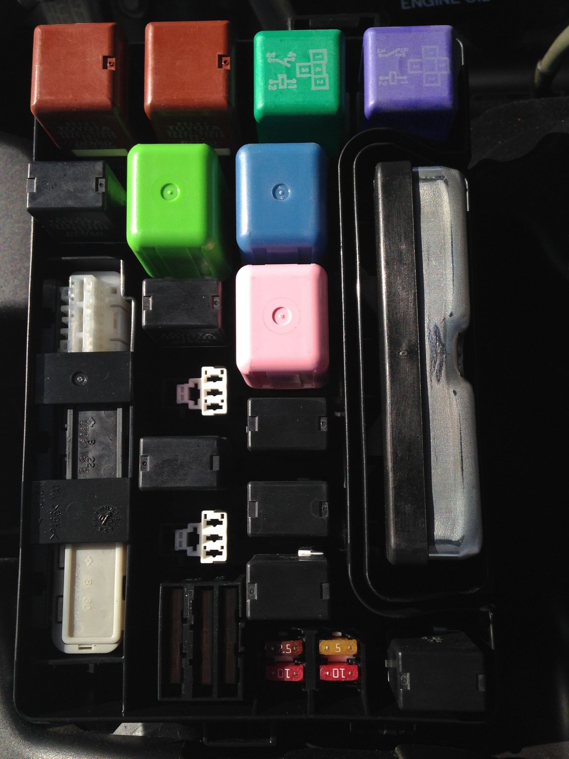

What the heck, going to wash my car this morning, lol maybe the wireless will work then, just kidding! I thought I would take a look at this fuse box, according to the diagram on the plastic cover, looks as if a relay is missing?
Can someone please look at your fuse box and compare, am I missing a Relay?
Car is a 2003
Thank you!
Bob
Am I missing a Relay?
