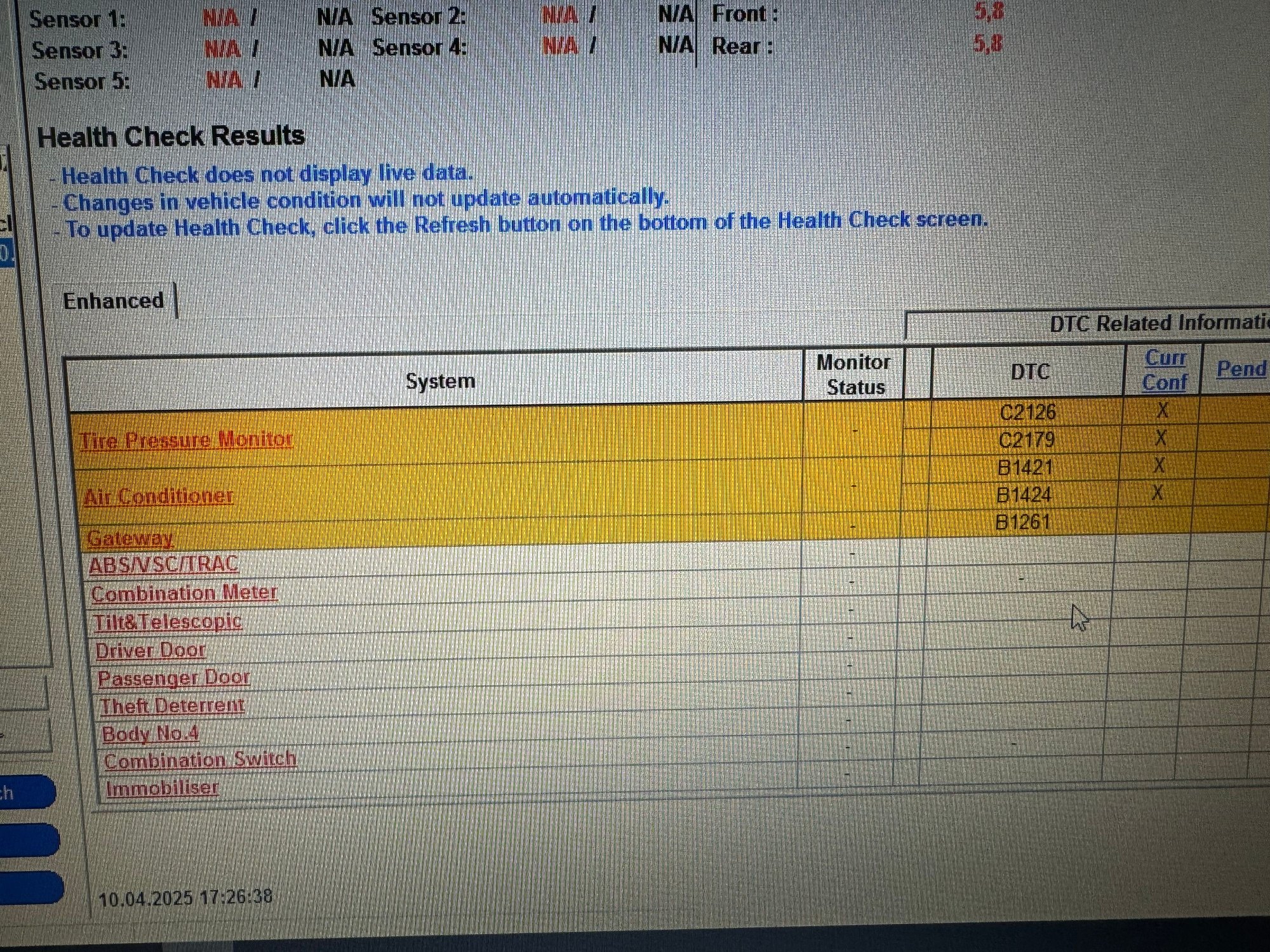

Hi, I’m looking for the pressure sensors (those from the rims) from the Lexus SC430 model from 2002, Europe.
OEM numbers:
1) 42607-24122 or 42607-24120
2) 42607-24112 or 42607-24110
3) 42607-24102 or 42607-24100
4) 42607-24092 or 42607-24090
Colours: red, white, gold and blue.
Where I can buy them?
OR
Because I could not buy the sensors (OEM numbers: 1) 42607-24120, 2) 42607-24110, 3) 42607-24100, 4) 42607-24090)… I think about replacement of control module in my SC430. Perhaps replacing the old Lexus SC430 Tire Pressure Receiver Control Module (89760-24020, 2002 OEM) with the newer Tire Pressure Receiver Control Module (89760-24051, 2009 OEM) could make a difference? That way, the sensors might be available... I’m looking for compatible system with PMV107K sensors for Europe car. I tried to connect module 89760-24051 to my sc430 and I had 2 errors c2126 (not all sensors were in good conditions) and c2179 - it is a problem!!
Techstream after connected new tpms ecu…
Could you help me?
Best regards, M.
