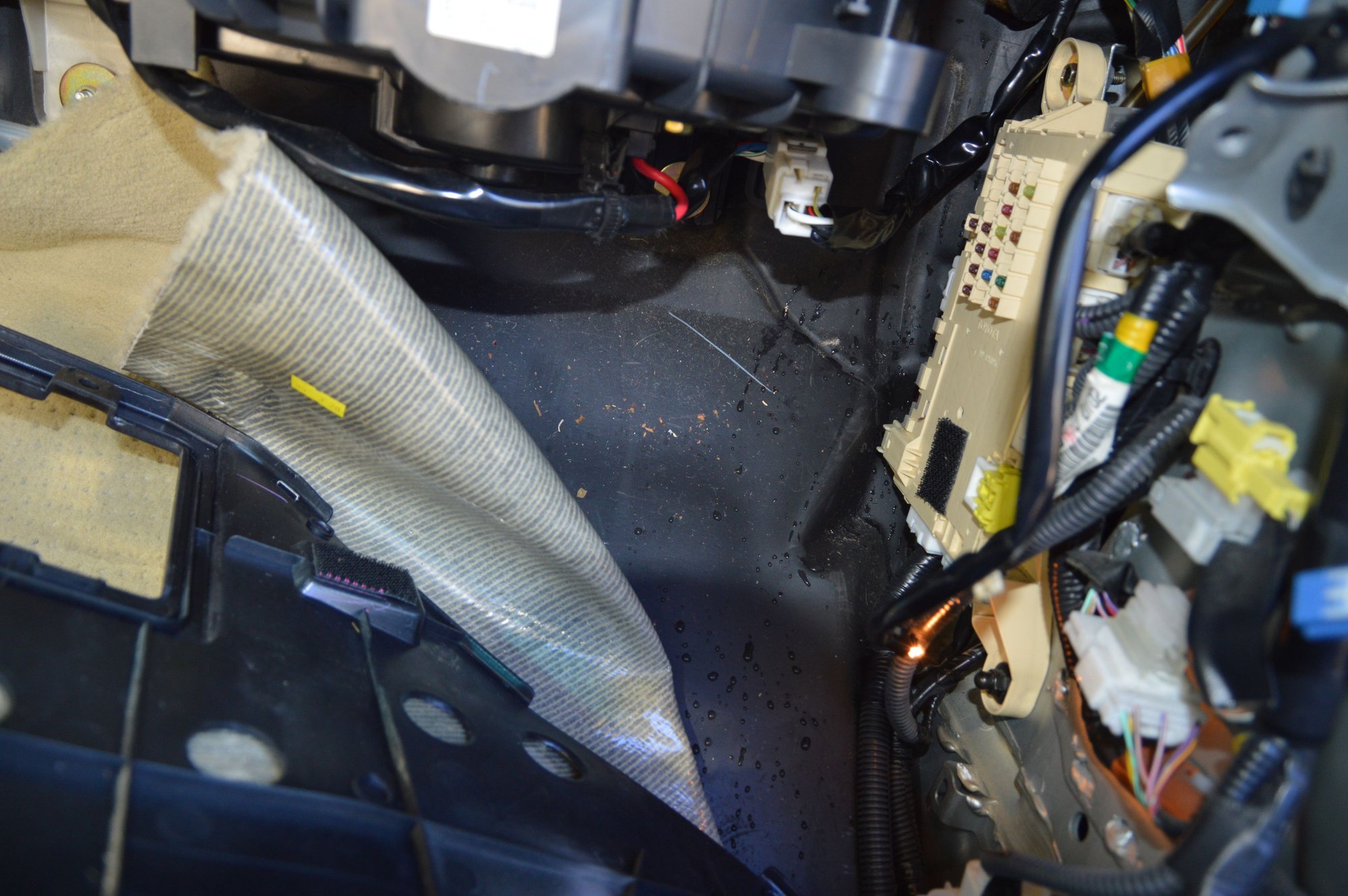

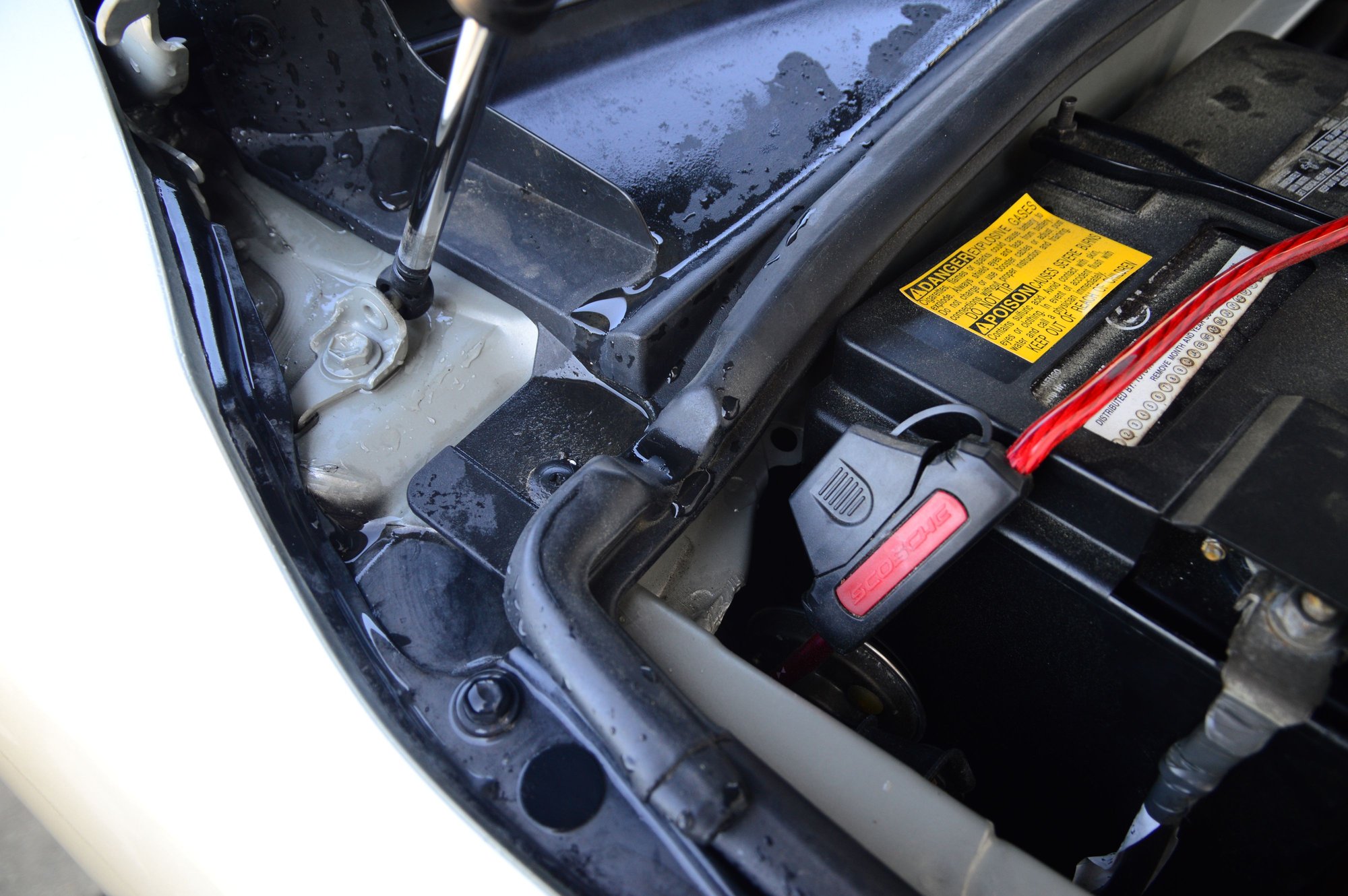

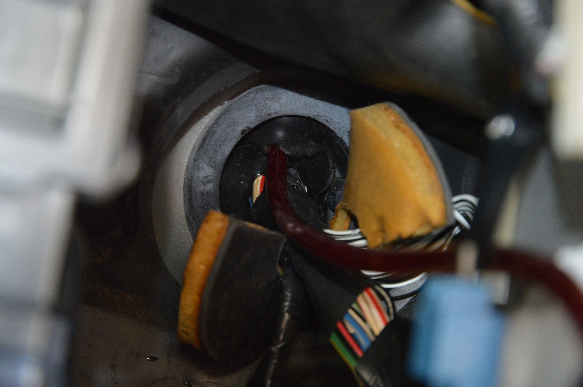

Sorry for the late reply, been busy. But apparently the grommet on the firewall tore after a while most likely due to the subwoofer power cable. The water would travel through the channel where the hood strut sits, down the firewall, across the cables through the hole in the grommet, into the cabin and constantly drip onto the fuse box. I went to autozone and picked up some black rtv and sealed the crap out of it. Probably went a bit overkill, but oh well. I don't have any pics of the rtv job, but I think that is fairly self explanatory. Thanks again to Shawn, totally helped narrow this down super fast.
