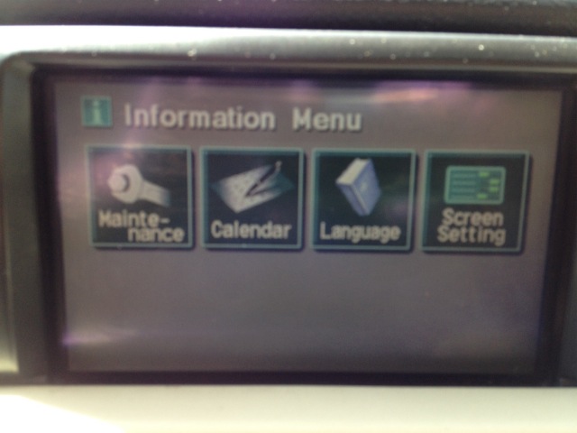

Just took delivery of my 2005 SC430 (Egyptian Sand, white leather, 55k miles. Lovely vehicle.) which I thought came with Bluetooth.
However, when looking to pair my iPhone 4S the 'Phone' icon is not present on the ML Nav Info display screen, suggesting that maybe Bluetooth is missing? I confirmed it's a 2005 from the VIN.
When I depress the little button below and behind the steering wheel volume buttons (left side - this is a US car) I get a voice saying 'No cassette inserted' or words to that effect, suggesting it's a cassette control button, not a Bluetooth one. The Nav instruction book which came with the car specifically refers to the presence of Bluetooth.
Can anyone advise how to find if I have Bluetooth or not? My iPhone cannot 'discover' anything.

That's the problem. The instruction book shows a fifth icon, the 'Phone' icon, missing from my display when I hit the Info button:
There are no screens to scroll with this display.

You are right you should have a telephone icon.
There is a hidden screen that gets you deeper into the system. You have to go to the display screen then press the upper left corner then press the lower left corner then press the top left corner then the lower left corner , Eventually you will get to a diagnostic screen . Perhaps some one turned off the blue tooth in this menu. Its a bit tricky to get to the maintence screen Some one else might give you better instructions.; You could allways take the car to the dealer and in a gesture of good will perhaps they would help you with this. I know there are volume adjustments in this hidden screen and this may be where your problem is. The dealer might just matterf of fact know what I am talking about.
