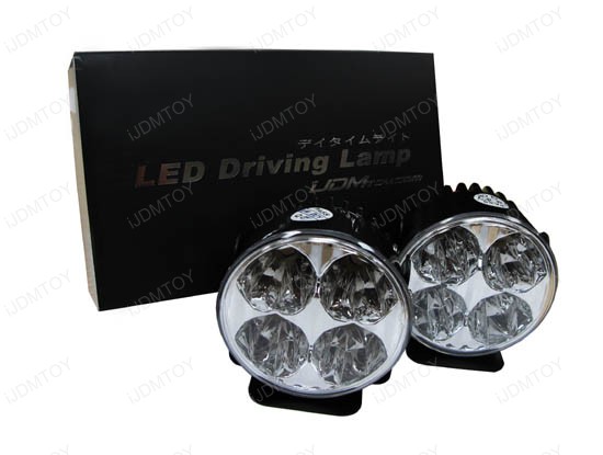

Not sure how large the opening is for the SC430 fog lights are, but if you guys are looking to do a set up similar to the one above, you can go with these:
http://store.ijdmtoy.com/Hella-90mm-...tm&click=35328
2.75" in diameter and produces about 4W of power. 380 lumen per lamp, basic bracket and screws are provided, but you may need more depending on how you install it.
Let me know if anybody is interested
