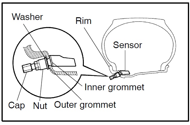

I am sure this has been answered but I did a few searches and came up empty.
I have a bad TPMS sensor on my R/H Rear . It has a red dot on it. If I buy a new red dot TPMS sensor from Sewell and install it will I have to go to the dealer to have it synced with the system or will the car figure it out and the light on the dash go out? The sensors are 8 years old so they are due to fail but I would like to do them 1 at a time if I don't have to go to the dealer to have them synced.

I'm not sure if all senors marked in red, white, blue and gold use the same transmitter ID identifier color. In addition, you usually need to replace the rubber grommets due to wear.

Yes, the installation kit with new grommets is only $5. I would think they wouldn't bother to color code them if the transmitter id was going to be different, otherwise what would be the point?

TPMS programming will have to be done by the dealer unfortunately. Hence when I change my RFT, I shall extract my TPMS and sell them.
