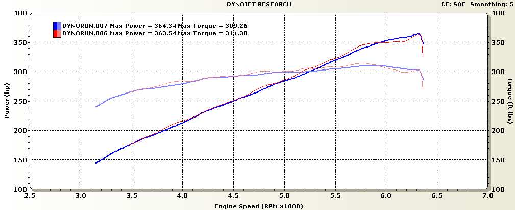

It means that when SRT does the dyno, they have a little ECU module that locks the torque converter and keeps it from causing spikes in your dyno reading. It's more important when you have a high-stall aftermarket TC which can give a big false spike reading in TQ early in the dyno run.
I've been to at least a half dozen dynos, SRT is the only one who knows Lexus tech stuff well enough to make this work.
Here's one SRT did of my car early on (I'm up about 25 hp from this one now), I'll try to find one done elsewhere for comparison.
EDIT - this one is from prior to FI, and it is on a Mustang dyno which without any adjustment reads significantly lower than a Dynojet BUT you get the idea of the torque spike I'm talking about
