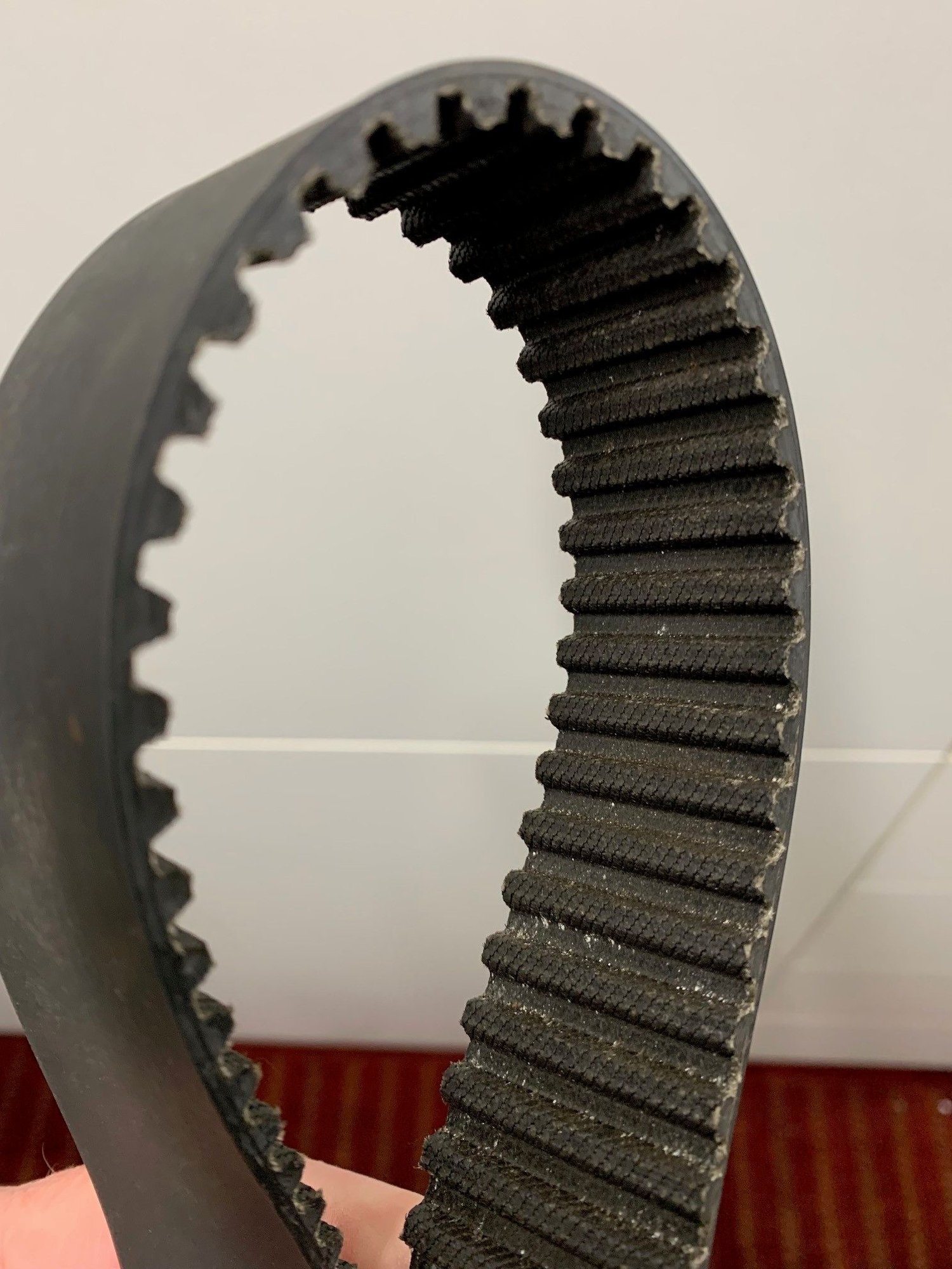

Just replaced my timing belt with the Aisin kit from rock Auto. Last done in 2012, but only 15k miles since. Belt, water pump and idlers were like new.

For your concern on the timing belt, if you want to continue to drive it you can inspect is by removing one of the cam covers on the top right/left on the engine. There should be 3 or 4 10mm bolts. If your belt is cracked, frayed, or ripped in any way you need to replace it very very soon. If you dont know what a new belt feels like just go to a parts store and ask for an accessory belt. The biggest thing is the rubber. It'll age out and become structurally unsound and thats where the 90,000 mi or 9 years comes in.

I have a 2008 SC430 with 70K miles and the TB has never been done. At this point, I'm seven years past due on time, but, 20K short on miles. I'm not too worried about it because of the extreme low incidence of broken belts reported on this engine. I basically have the same engine in my 2001 Tundra and did that TB when it was about 5 years past-due on time, and about 20K over the 90K interval. The Tundra TB that came off looked like new! However, doing the job did eliminate a cold start squeak (one of the pulleys). I've done four TB jobs on Toyotas and all the old belts have looked like new, and two were far past their change intervals. So, based on these experiences, I'm going to hold off on doing my 2008 until it reaches the 90K mile mark.
