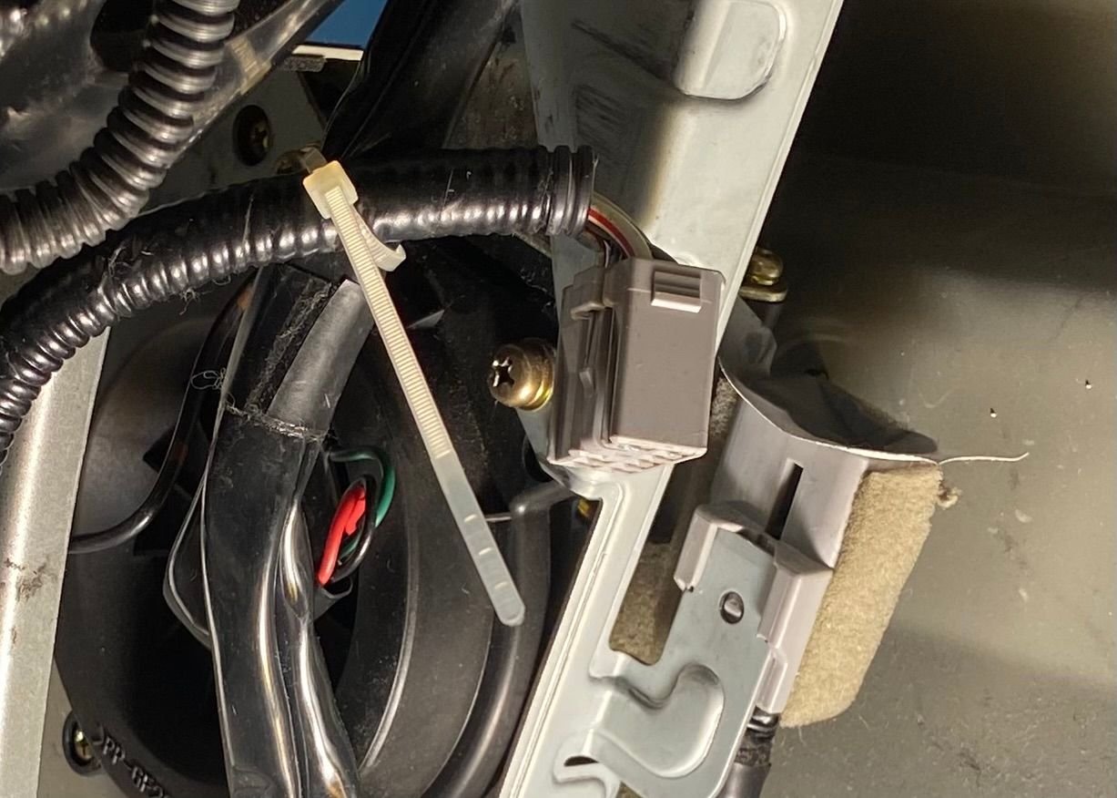

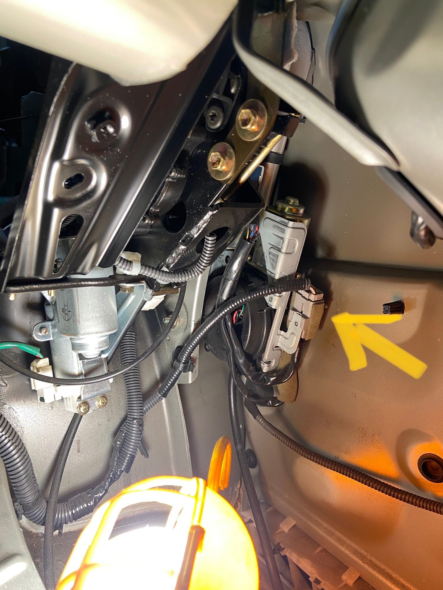

Originally Posted by Bgw70
You only disconnect one plug to disable the antenna, the plug is next to the antenna motor.
i just did this recently after pondering it
for years. if i can do it, it’s definitely doable.
there’s a vid at the end of this thread showing which trunk panels to remove to access the antenna motor. i didn’t pull the last panel all the way off. i just folded it out of the way so i could reach in and unplug the connector.
https://www.clublexus.com/forums/sc4...isable-it.html
here’s a pic of the plugs location and where i just strapped it out of the way after unplugging.
all in all, very happy with the result!
hope this helps.
