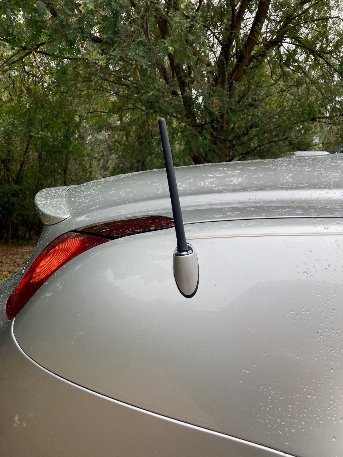

Ok guys, below is the final antenna change out.
Purchased via Amazon from AntennaMastsRus. Not cheap but the customer service is great.
Since I don't have the stock radio, I was not able to follow the "hyper extension" process for ejecting the mast along with the toothed cable.
Called the folks at AntennaMastsRus and got excellent directions on how to proceed. Complete installation in 3 minutes.

Below are the steps provided:
1. Remove the retaining nut on the mast -- I used a pair of needle nose pliers (be careful)
2. Turn on the radio -- the antenna will extend -- pull up if you need to in order to access the toothed cable
3. Using a pair of vise grips -- secure the cable as close to the car as reasonable.
4. Turn the radio off -- the toothed cable will try to retract. Since it can't, the radio will assume it has been completely lowered
5. Turn the radio back on and the entire cable will come out.
6. Insert the sleeve from the new antenna
7. Re-secure the retaining nut
8. Screw the new antenna into the sleeve
They recommended having a second person in the car. I did it alone by accessing the key from the passenger's side of the car, thus I was very close to the antenna and didn't miss a beat
Hope this is helpful.
-gene
