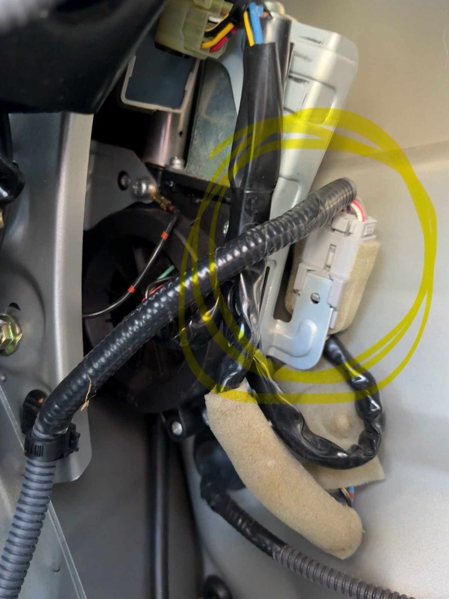

Old Mar 22, 2025 | 03:49 PM
lfam23's Avatar
lfam23
1st Gear
Joined: Mar 2025
Posts: 1
Sorry to re hash this ..
Originally Posted by ShawnOk
Unplug the harness and you're good to go.
are you saying to disconnect this cable i circled in yellow?
i disconnected and started the car and it xapped the battery some how. Recommected and jumped the car and it went back to normal but wanted to ask before trying it again, thinking it was a fluke.
TIA!
