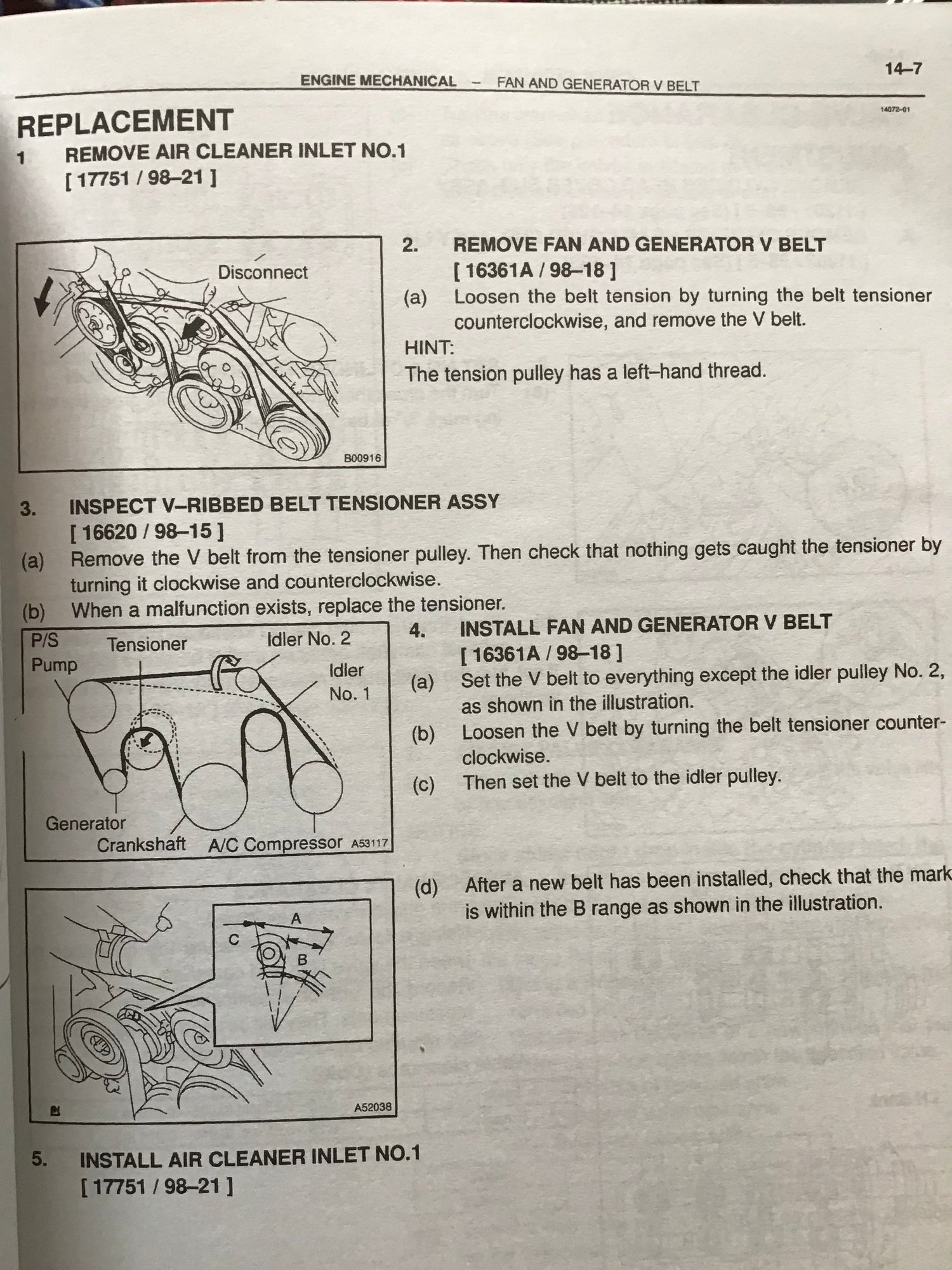

Here’s what the repair manual shows for belt replacement. Hope this might help.
