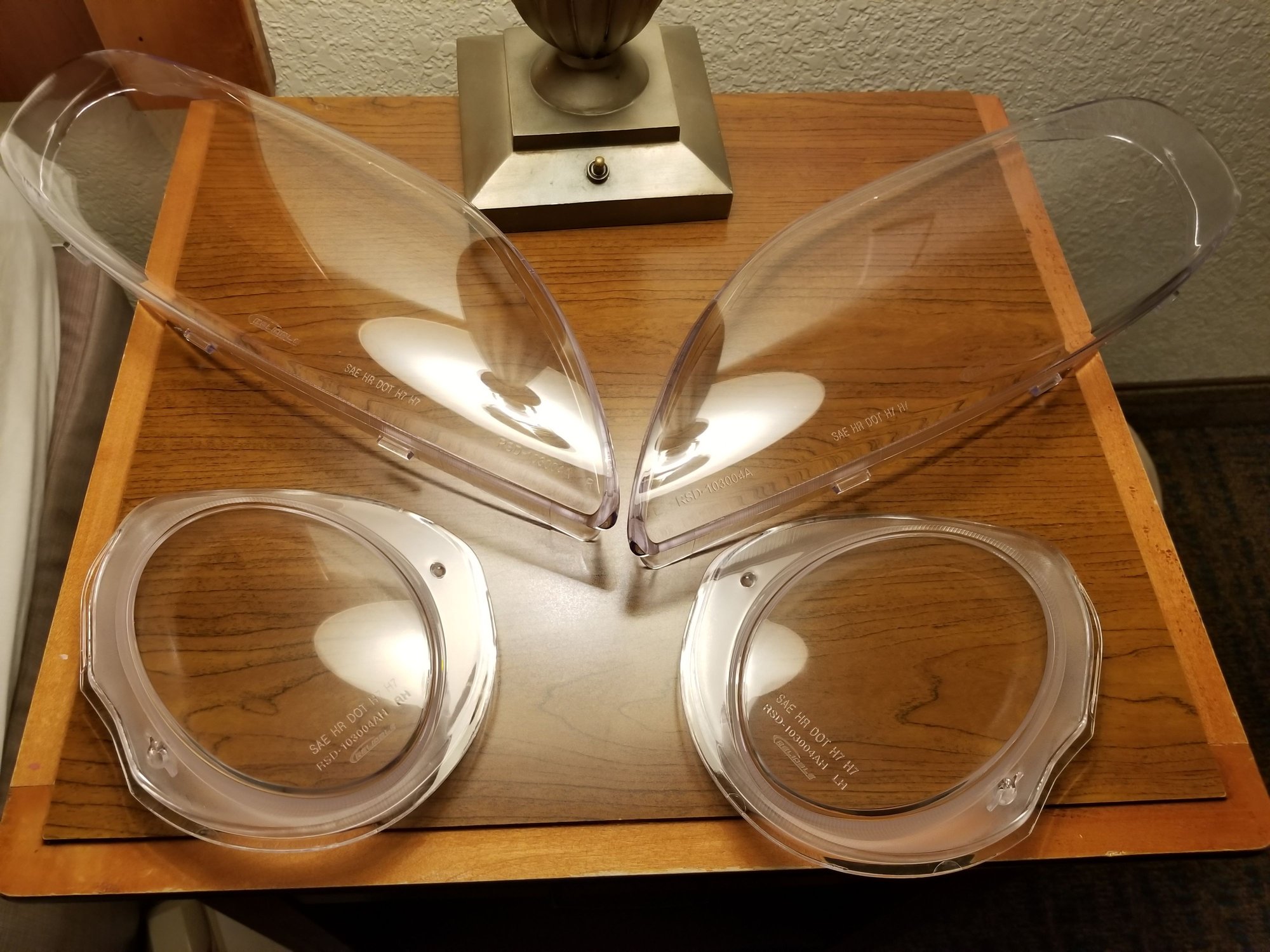

Not performance related but more aesthetic will be added to improve the looks of the car when on the track or just parked at car meets. Not a fan of the oem lense with the vertical lines so i scored these!
Here's a link
https://messy-garages-automotive.myshopify.com/products/lexus-sc300-sc400-toyota-soarer-high-low-beam-headlight-clear-lenses

I like that, especially line free, let us know how they work out
My lenses have been a pebble in my shoe for quite a while.
They are 30 yrs old and have a hard 300,000 miles on them
I could use those lenses

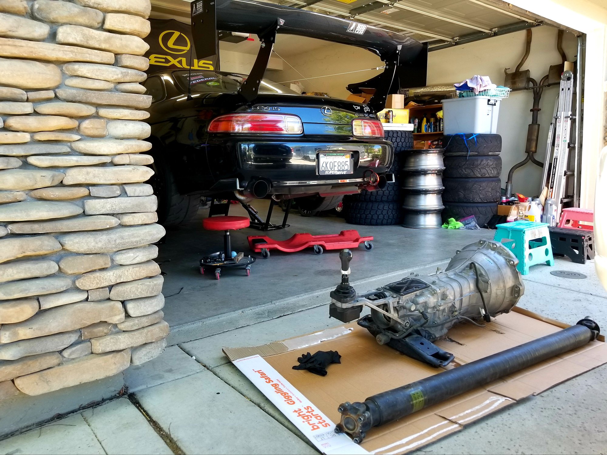

I had some time this weekend to put the diff back together and sealed it up. Then decided i can use an additional 1½ clearance on my quickjack lift, so i decided to go buy some wood and chopped them into size to make it happen. The SC is now lifted and ready for the diff swap. Hoping to complete it this coming weekend
It's a little filthy, a quick wash should clean it up
New toys
Great view
Ready for take off

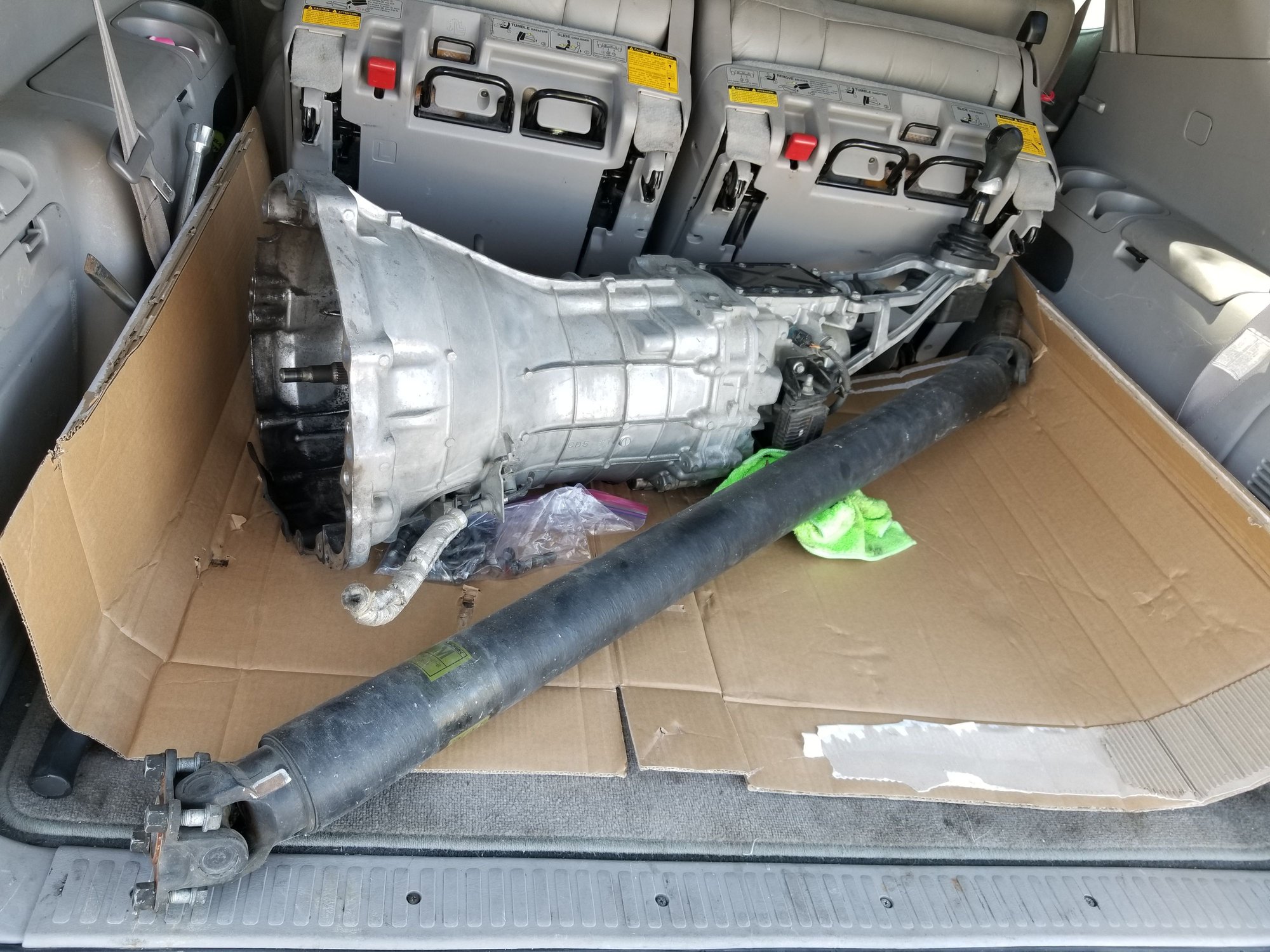

Manual conversion coming soon... not sure how soon but i still need to source more parts before i start tearing into it. Picked up a 6spd gearbox that was from an 07 350z cd009/jk40. The seller even threw in the carbon fiber drive shaft (not sure if it will work for the sc chassis) i checked the vin and confirmed that the gearbox is indeed the revision and updated synchros.
Notice no clutch fork or external slave cylinder on 07 and up 350z gear boxes
