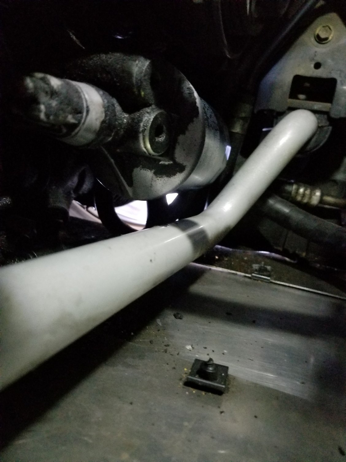

Now this mod is specifically for sc400 owners. It's about people running whiteline sway bars that would hit the oil filter housing. One member shared a solution but would result in an oil filter relocation setup. I happen to have a spare set of battle version endlinks that i just chopped off ½" of the thread and coulper itself to shorten it. In the pics i tried to simulate how it would behave under cornering and this is my result of clearance from sway bar to filter housing. Another way would have been shimming the sway bar mounts but in my situation it would require alot of hardware to undo from the from splitter to access. One other thing to mention is that if your vehicle isn't too low then you more than likely wont experience this issue at least from my experience.

Ingenuity at work!

bboyjohn04-- your new helmholtz resonator changes make your V8 sound brilliant!! That's how the SC400's should have sounded from the factory! Wow!! And excellent work getting the whiteline sway bar to clear the oil filter housing! Your car's whole setup and look is so mean!!

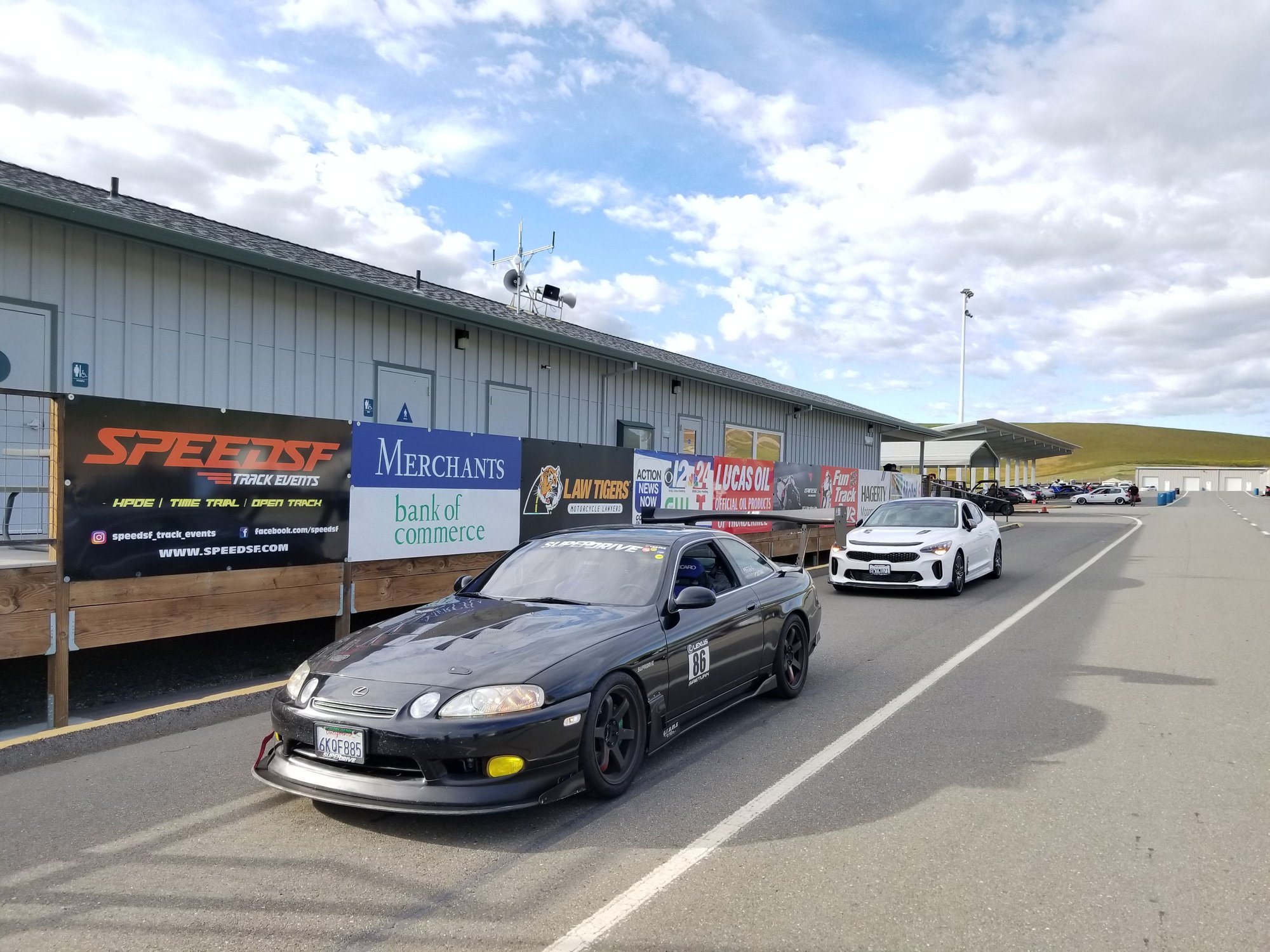

Well, all the recent Mods made a significant difference. I ran 4 seconds faster than my last personal best at Thunderhill Raceway west course. Couldn't get the car to sub 1:33 before but left with a 1:29 this time. The lighter wheels with wider tires square fitment definitely played a roll along with the light weight battery swap. Next I'll dive into the headliner and sunroof assembly delete just to continue to chip the weight away.
The car felt amazing, very responsive on turn ins and outs. The ls400 calipers with ebc yellow pads and ebc slotted rotors paired to stoptech ss lines worked extremely well especially late brake entries given that it is very underrated. I need to figure out how to over lay data onto the videos but until then here is a time slip and footages and pictures
From 3/5/22 Thunderhill Raceway via Corsaclub_us
