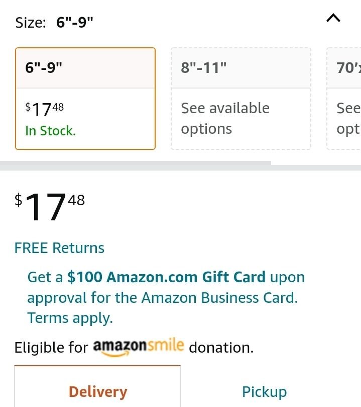

Bought some front splitter rods to push the front splitter down to get a slight angle/rake. Install wasn't too bad and it looks a bit more aggressive now.
Notice before completing both side that left has rod and is already added a slight push down on the front splitter compared to right (rod not installed yet)
Finished, will habe to go thrash it arpund on next track day to see how they hold up. I won't be surprised if they break but i now have an idea of what will be needed to make my own out of stronger material when it happens.
