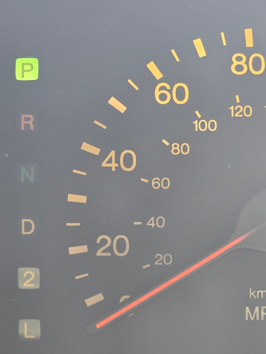

My speedo is off, between 25mph between 0- 25 and off by 10-12 mph above 30mph... Holds cruise control and shifts properly. So I've been hunting the yards for spare instrument clusters in case I need to replace mine, or need spare pieces... Found a couple SC4s at a local yard and snagged Idlers, clusters and AC units. Picked up a 94 and a 93 cluster, the 94 looks like its gauges were already replaced. My 93 is a later version, may be compatible with some 94 parts. If not then I'll offload it on ebay. No mods have been completed besides the ones already mentioned previously.
Assuming I've broken welds due to the love taps to jump start the tach...

Adding an image.. Speed and this lighting going out and off seems to be connected, as well as my TRAC light starting to come on and off. Below the 50mph its dim day and night.
