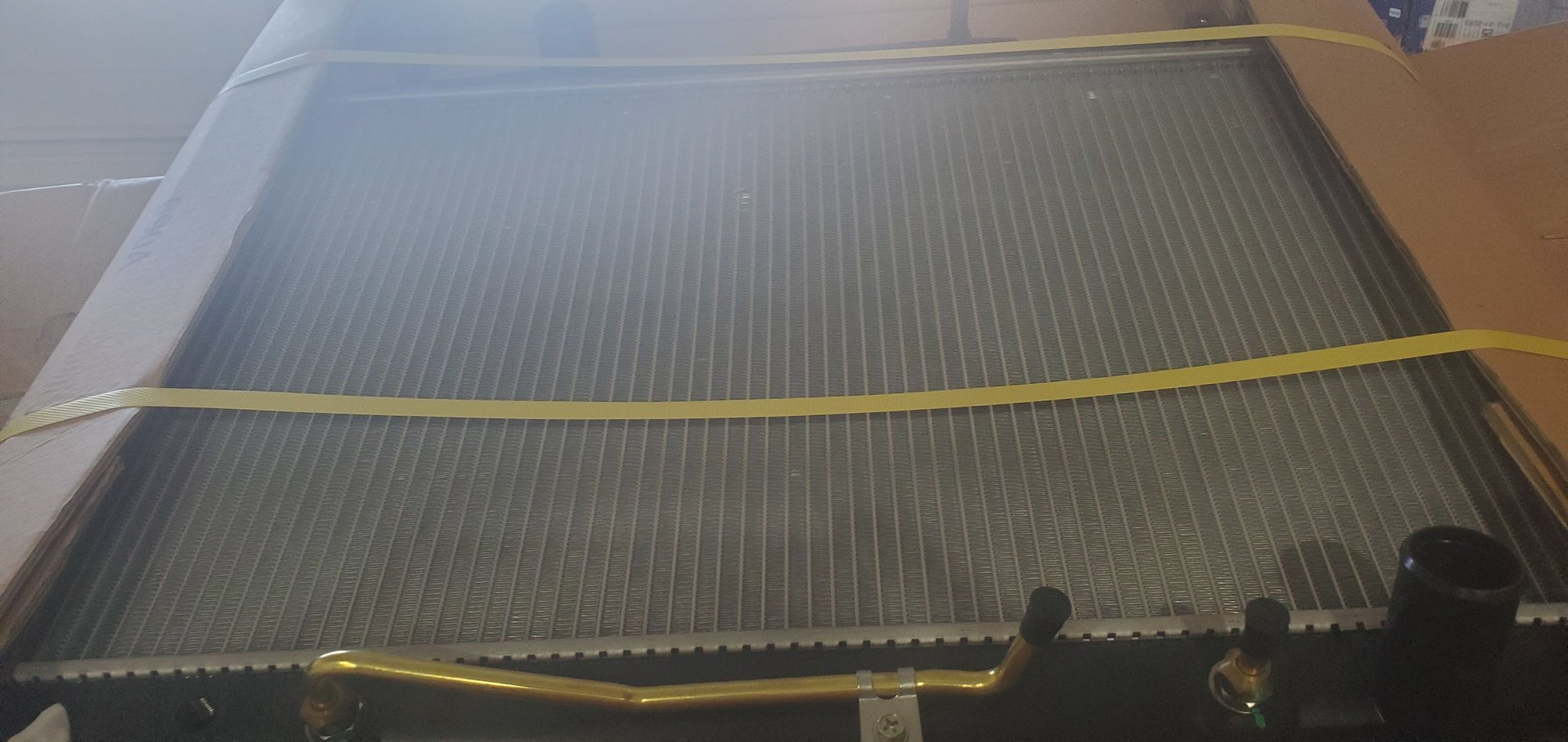

Well I finally replaced my radiator, after dragging my feet, a move, new cartwheeling schedule, and a few things that keep me out of focus... Eitherway managed to separate the fan shroud from the radiator in the car and pull just the radiator out... Did get a union bolt and brass gasket in case this plan didn't workout and I had to remove the fan shroud with the radiator and deal with the fan fluid... Got a regular Denso radiator to replace the original unit, and now I have heat, cuz its cold af out here at night and early morning..
Old and busted
New Hotness
Radiator egress and fan shroud remains... didn't find anyone post something like this, so if anyone feels lazy enough it can be done... a face mask is good on this one when working from below cuz I got a drop coolant in my mouth while swearing, LOL... That's what I get I guess.. LOL..
