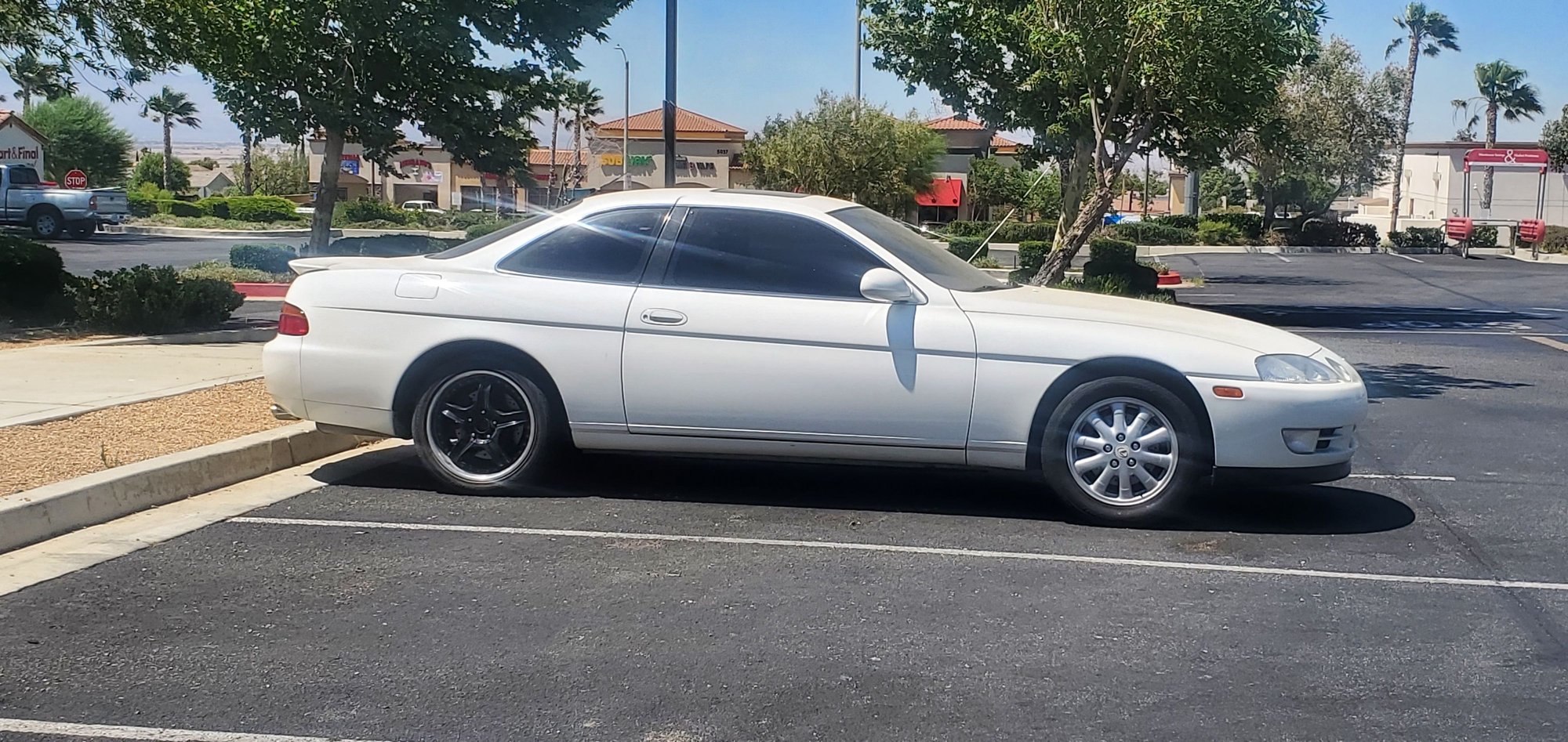

Last week she looks raggedy... Stock front with matching tires, 2 different wheel in the rear with matching tires as well... The 18's will have to wait for now.. FedEx and America's Tire's logistics were slighlty off, but no biggie, should be getting my 4th tire today or this week.
