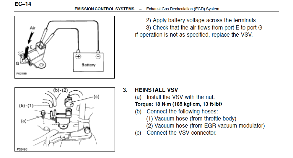

Second, you will need to start diagnosing your EGR system. You will have to test the EGR VSV's +12V on/off function to confirm it's working, then test your EGR temp sensor for continuity while the engine is running (should measure 69-89k at 122F, 12-15k at 212F, 1-4k at 302F), then you need to actually remove the EGR valve, EGR pipe and the remove the upper intake "Y" manifold in order to clean all three of them. Also you need to make sure your EGR vacuum modulator's internal diaphragm is working properly. Rarely do the EGR valves go bad but anywhere that EGR gas flows you can have carbon clogging.

The EGR VSV is only made by Toyota. You can get one new or used. Those can go bad after a very long time but its still best to test the one you have on the car before jumping to replace it. It's very simple: get some small electronics electrical wires with alligator clips at each end, clip one wire each to the pins inside of your VSV's connector end, note which is positive and negative and put the other end of the negative wire to battery negative and then put the positive wire's other end briefly to battery positive. A good VSV will click on as you briefly connect the circuit and off as you disconnect the circuit.
