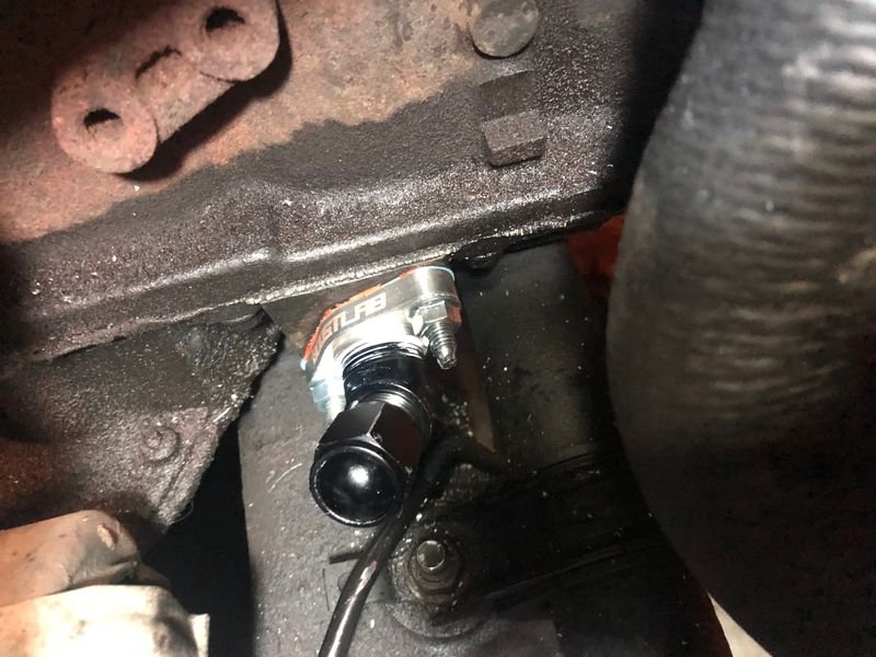

Started preparing for the NA-t upgrade. Here is my task list:
- Replace Valve Cover Gaskets
- Install Cometic GTE head gasket
- Install Oil Filter Flange O-ring and ensure that all other bolts are sealed appropriately
- Drill & Tap the Union Bolt for the Oil feed
- Drill the Pan for the return line
- Clean and paint the throttle body, intake pieces, and valve covers
- EGR Delete
Here is tonight’s progress
Start
End
Drilled & Tapped

Removed the head, and spent about 10 hours scraping the old head gasket off of the block and head... I think I’ll pay if this has to be done again. Placed the new HG in place and screwed the ARP studs in place. Waiting on the appropriate 12 point socket to fit the ARP nuts... Neither the 14mm or 13mm that were recommended fit...
Anyway, there are two broken bolts in the head... One of the EGR tube bolts broke and one of the VC bolts... So I’m waiting on the appropriate tools to remove those.
While I was waiting, I did the oil drain
Next, I’ll continue to clean off the block... There was a really bad coolant leak down there... This car had so many leaks!
