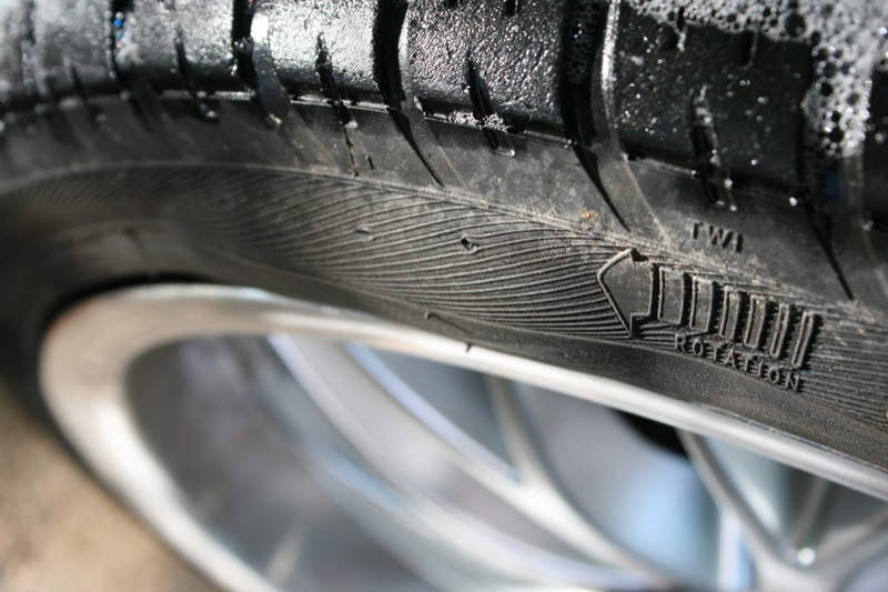

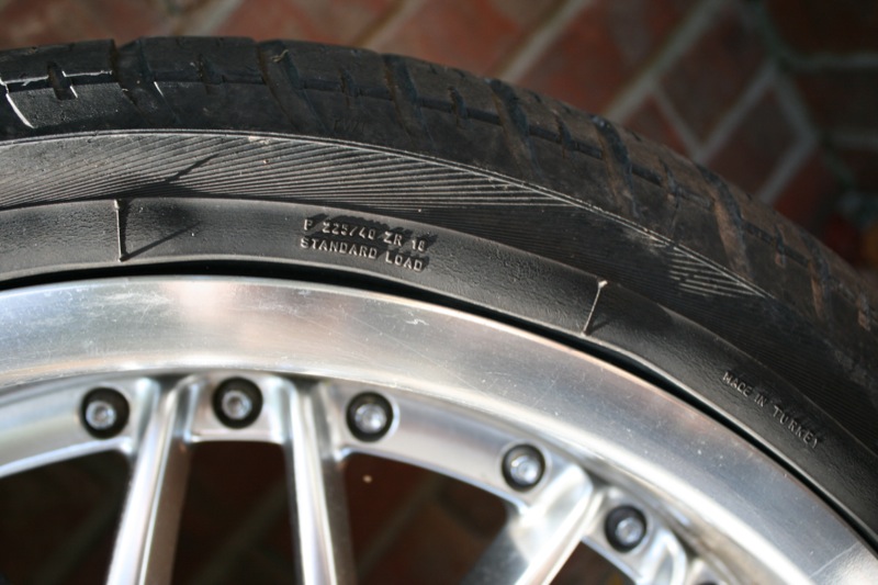

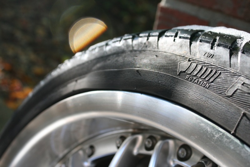

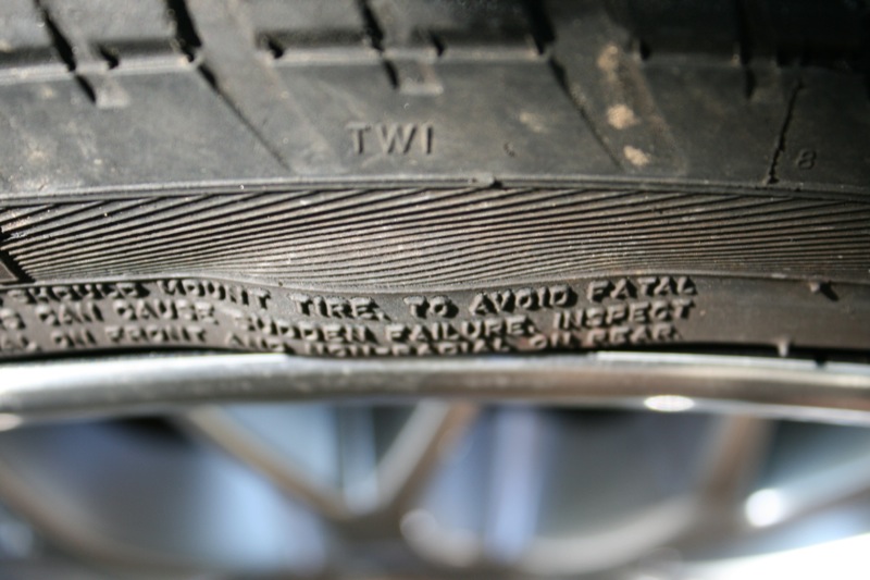

Cold tire pressure and warm tire pressure can change pretty dramatically when you run low profile tires. Today my 40 series separated from the alloy wheel, went flat, and I had to get it re-bead locked to keep it from leaking.
It's very common for alloy wheels to release their bead in cold weather so make sure your tire pressures are correct this winter because if you have a weak bead and pop it while driving hard in a corner it can be dangerous. Even if it is sitting still you can wake up to a flat tire and be late to work or school. (I woke up to a flat today).
So for safety and to keep from being late to where you need to be, watch those tire pressures and be weary of the bead on alloy wheels in cold weather.
