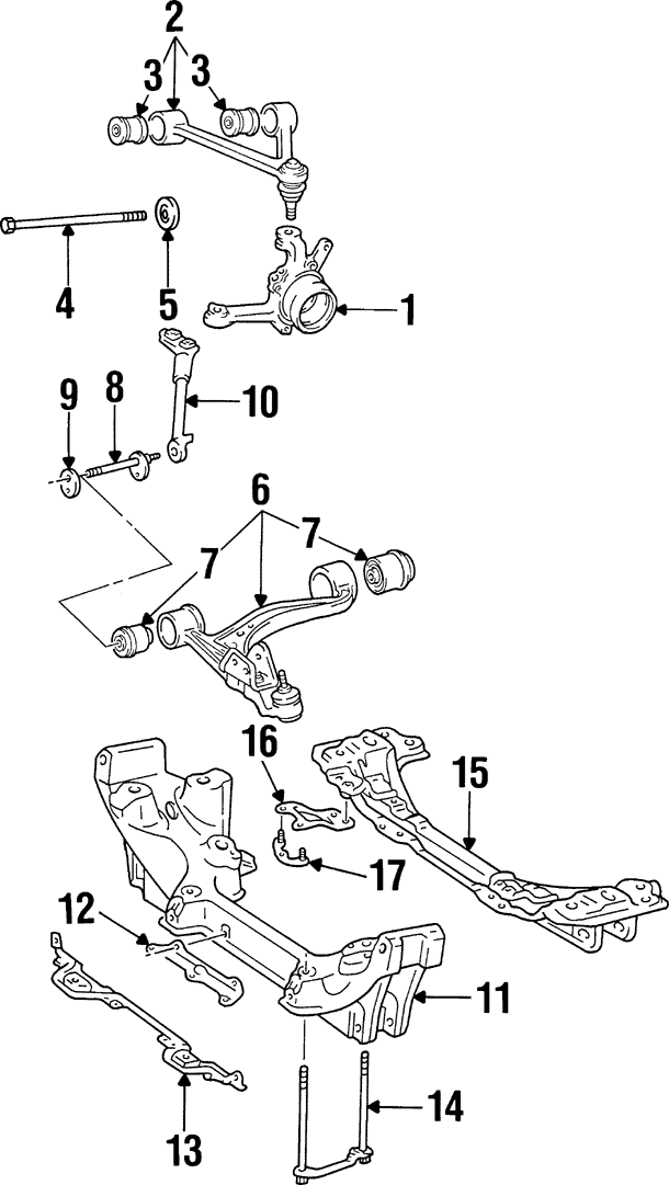

[IMG]c:\temp\Stabilize bushing.gif[/IMG]
HI,
Has anyone replaced the stabilize bar bushing (front) for SC300 (part #2 & 3) , please let me know that some thing I can do by myself or have to have the shop to do it. I also attach the image with this message.
Thanks.

I did not check the upper rubber mount when I replaced the struts. (Fig. #15). The noise usually comes when I brake real hard. Or when I brake and go over the holes/bump, then the clonk clonk noise appears and it drives me crazy. Please let me know if your problem solve when you replace the struts.

If it is the lower control arm bushing, then can we replace the bushing itself? I understand that Lexus does not sell the bushing alone, we have to buy the whole set of the lower control arm.
However, I have been reading the posts that Supra has the same suspension with the SC series. I saw Parts.com is selling the bushing itself for $1.50 (l know that it is less than 2 bucks). So the question is: Can we replace the bushing alone? (No.7)
Thanks.

I imagine you'd need a vice or something to press out the old bushing.
You may have to destroy the old one, drill it out. I think the reason Lexus doesn't sell it separately is that from the factory the bushing is physically molded into the arm. Right? If you can successfully do this, the process would be a help to alot of us.

If you go to www.parts.com , they show everything for the parts they sell.
