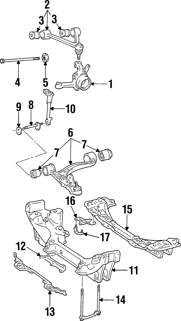

I have tried to order the bushing alone from www.parts.com. You have to order for the Toyota Supra bushing since SC series and Supra use the same suspension if I am not wrong.
It costs ~$1.50 each. They said the item is backordered and will ship to me by end of this week. Hopefully they will find the bushing. I'll let you know when I receive it. It's no. 7 on the pic.
