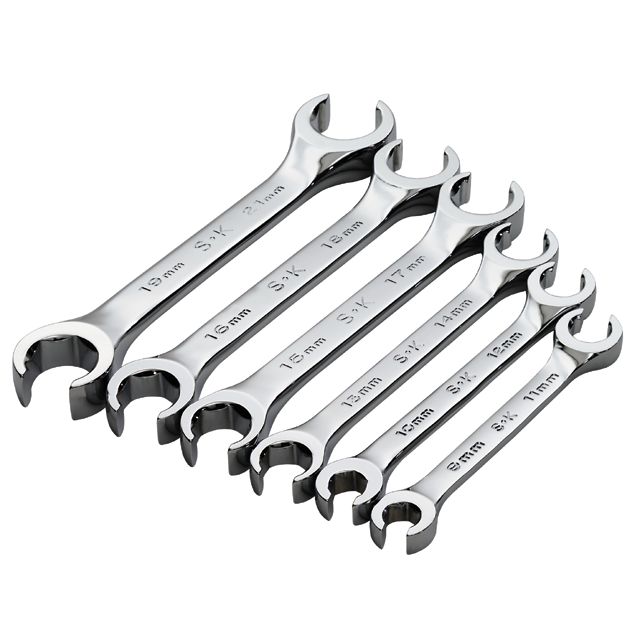

Try using a 14mm line wrench as well.
yes yes yes yes! you should have been using a line wrench to get it off with out rounding out the filter. i had a hard time but thankfully i have a set in my tool box at work.
Old Apr 11, 2007 | 08:07 PM
RedPhoenix's Avatar
RedPhoenix
iTrader: (10)
Joined: Oct 2006
Posts: 5,006
From: Tampa, Florida
i have been. They are called flare wrenches. i bought a set for my camry's fuel filter. THAT tool rounded my 14mm bolt on the fuel line. i wasnt lieing when i said its stuck lol
