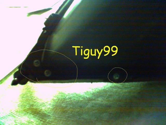

It mite help to angle the headlights upward slightly as well. Towards the inside is a sharp point, don't kno why it's there, but that tends to get caught on the inside of the bumper easily. So you have to aim up slightly and pull a little upwards along with pulling it out.
*edit picture
you can see that pointy part on the far left slightly under the perimeter of the circle.
