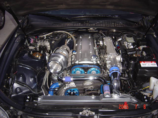

Check out the SP88 we did on this supra. OMG! makes my SP74 look like a t25 Originally Posted by JustinDD91
Correct, now an SP88 is what you want
88mm. Make boost on a 1jz at around redline. But boy o boy what a redline
Vs. my sp74
Which one's the block?
