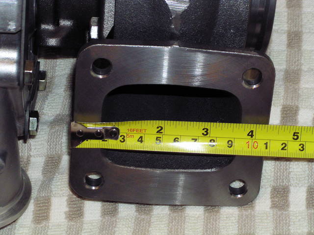

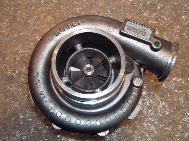

I have decided to go with the GT40 due to its wheel being 30% more efficient than its predecessors, and its extremely quick spool up. The GT40 requires custom flanges to be made, so I had Precision make up a custom housing with a .68 AR, and standard V band. The flange is a standard T4 connection. The GT40 will support up to 750 HP, which will easily provide me with my project goal of a 500+ RWHP daily driver, on pump gas.
It has been a long wait to get thet Custom Housing- 3 months. But, it just came in today. Now I can finally get the custom piping made...
Ryan
More to come
Ryan
Ryan
More to come
Ryan

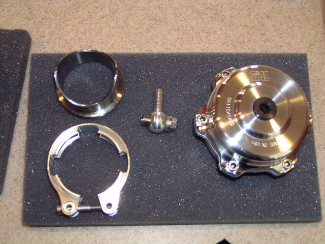

I am nursing a sinus infection today, so these items coming in the mail were a ray of sunshine to my misery...
More...
Ryan
More...
Ryan
