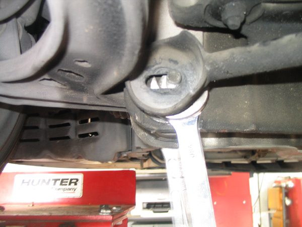

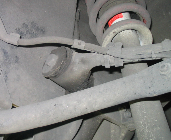

according to NT&B and upon self examination / inspection, it appears the new polyeurothene bushings on both the front upper control arms have failed....]
will post the pics later today.....
Eeeek! I've often wondered if this was possible, and dreaded the thought. So, I'm guessing what you're saying here is that the steel shells that are pressed into the upper arms which allow for the offset mounting, have slipped and spun out of they're original setting? Did the shop that installed them use some sort of lubricant to ease installation, but in turn, allowing them to slip? I suppose you won't know that off hand. Is it just the fronts that are affected, or did you ever even install the rears? How long did you have them in before you suspect they failed? I've had mine in since February, and so far no problems that I can tell. I've had no wear issues, and when I had all four wheels off last weekend to install my coilovers, they still appeared to be holding in the positions I set them. Has anyone else out there had the same problem? I'm beginning to worry.
I guess another option for the fronts would be to install the pricey JIC adjustable arms. However, I've heard that these are intended for drift cars and may not provide enough positive camber adjustment.
Here they go. Notice where the control arm is sitting. From what the mechanic showed me ( to whom seemed very knowledgeable, and I was there the whole time watchin ), the upper arm is in to far because the bushing wasn't holding it in it's proper place due to failure, and the bottom couldn't be brought in to straighten the wheel out because it was maxxed out as you will see in the second pic.

Wait a minute, hold up. I'm looking at these pictures, and your upper arms look exactly as they should with the Daizen camber correction. You see how the circular shape of the upper arm eyelet is protruding on the outer edge? That's what it should do. The kit essentially lengthens the upper arm to add positive camber. So, those did not fail as far as I can tell. At the full two degree setting, the arms are only tipped out about 5mm, which looks right by those photos. The only way you'd not be able to adjust the lower arm enough, is if your car is really low. What kind of springs or coilovers are you using? Is the car slammed? If you've lowered your car more than say 2.5", the Daizen kit will not provide enough correction.
Originally posted by NAZTY97
The car is only lowered 1.25" all the way around. The top control arm cannot be adjusted, thus static. The bottoms cannot be adjusted enough to correct the tip-in of the top.
Your upper arms are doing exactly what they were designed to do with that camber kit. Push the arm out. There's nothing wrong with those there.
I think that the consensus here is that mechanically your car is fine. The camber kit appears as it should, and you haven't lowered your car enough to render your car unable to be aligned. So, something is not right here. Your tires were wearing on the inside edge, right? I would think your tires would be wearing on the outside due to positive camber, if NTB is actually sliding the alignment bolt all the way in. Have the rears been wearing okay without a camber kit? If so, that should tell you something about what these guys are telling you. My only real suggestion is to take the car somewhere else.
