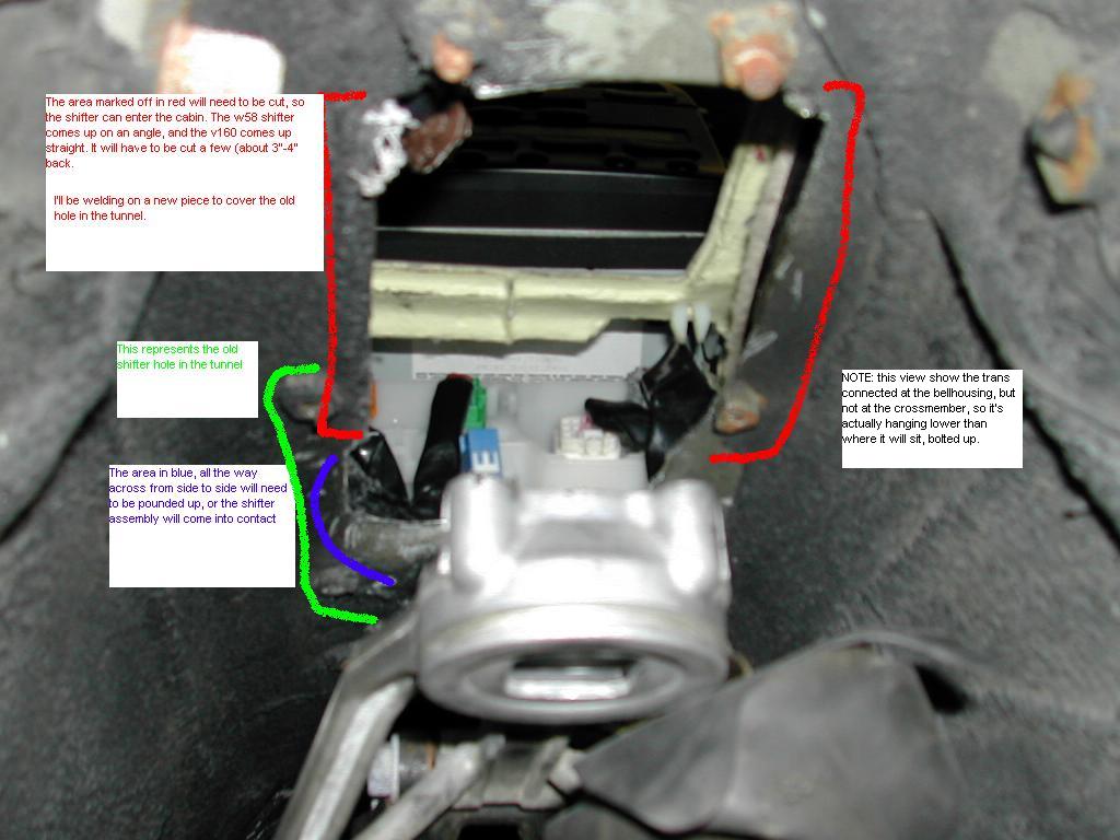

Default Shifter area
Ok, here is a pic with some notes on what and where the tunnel needs to be modified around the shifter.
It may be a little confusing. Also feel free to pm for details. I'll get the other pic up of the tunnel, however, I think bmsport has a better picture of where it needs to be pounded. Hopefully he will see this post and link it in. I think the most contact came from the shifter area. I only pounded up the trannel tunnel a slight amount, and it doesn't seem to have any interference.
Hope this helps a bit.

Old Dec 26, 2003 | 01:47 PM
bmsport's Avatar
bmsport
Joined: Feb 2003
Posts: 736
Glad to hear this information has come into the clear, great picture, much better than mine...
http://www.brevardmotorsports.org/im.../trannymod.jpg
Can't wait to see that thing run, hell, mine too.
