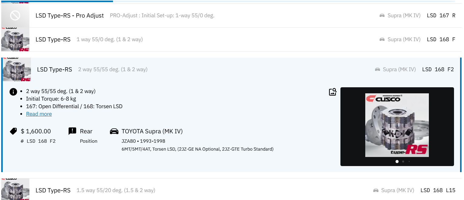

Hey all, I just ordered a Cusco LSD for my SC and I dorked up and didn't notice the part number was for a car that had a factory torsen LSD in it. My car being a factory open diff car, how screwed am I? I've tried searching around, both here and the internet in general, and I'm getting the impression that it shouldn't matter but I wanted to see if someone on here could confirm or deny that an aftermarket LSD for a factory torsen car will fit into an open diff.

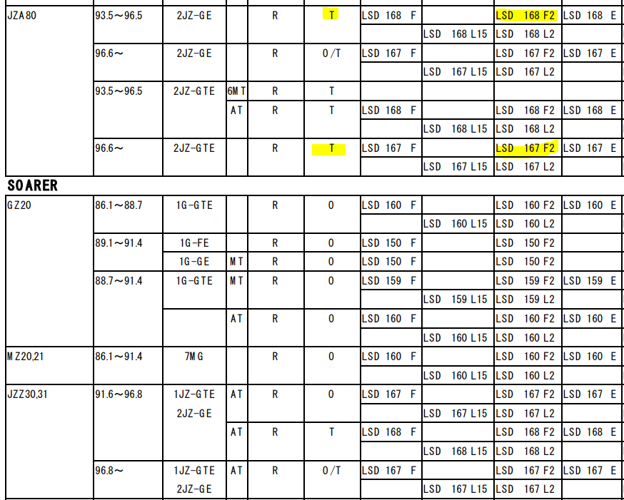

The part is listed for a Mk4 Supra, and I know the NA Supras have the same 200mm diff as an SC, but its a 168 F2 part number which Cusco lists as fitting cars with a factory torsen, but it seems the open diff Supra takes a 167 F2 part number. I've been doing my best to read on the different diffs these cars came with and I think its going to be fine. I've read that only some Canadian SC's had a factory torsen, and various Japanese trims did as well, but no US-spec SC had any LSD. I just haven't been able to read if there were any physical differences, like case or ring and pinion or stub shafts or bearings, between the open diff 200mm and the torsen 200mm.

looking at cusco's spec sheet, the 168 F2 is used for their JZS147 aristo and JZS160/161 aristos; both these cars come with 200mm differentials ONLY. This number is also cross referenced to the JZZ30 (only came as a 200mm) and 2jzge versions of the JZA80.
Also I'm not sure what the differences are between the 168 F2 and the 167 F2; as it doesnt strictly seem to be in torsen differentials. AI on google says "the "167 F2" is a 1.5-way LSD, while the "168" is a 2-way LSD"
You are good to run this differential. Just make sure it is installed properly by someone who has done many differentials.

I was going off of Cusco USA website. It's not where I ordered from but it has the torsen/open for the 168 and 167. I like your chart better, I wish I had seen it before I asked this question, but thanks for answering it for me anyways.

I much prefer using the original japanese versions of the websites; as the USA versions are just resellers/customer support. Heres' the link for the original PDF
https://www.cusco.co.jp/en/pdf/L.S.D._toyota.pdf
